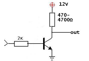

You described a circuit, in your first post, that leads me to understand that you used the emitter as the output and wired to your tachometer_in. The output of such would be < 5V.
I don't know how much current your gauge requires.
Try the attached circuit.
The output will switch 12V/0V.
Start with a high value for the collector resistor (and reduce it as may be necessary.)
*** The GND there is common to the transistor, the arduino, and the gauge/ckt. ***

yes i did mention using the transistor in a different way to how you've shown it, i found a few diagrams on the net that showed the transistor being used like a relay... 12 volts into the collector, 5volt signal from the arduino through a 1k resistor to the base, and the supposedly now 12 volt arduino signal to the tacho from the emitter,
i guess i was just using the transistor as a diode that way.

i've done the circuit with the transistor as shown, i've tried a BC547, a 2N5557 and a 2N3904 transistor, all do the same,
The transistor is working, i put 5 volts on the base, get almost zero volts on the emitter, remove 5 volts i get 11.07 volts on the emitter, my psu is outputting 11.10 volts, i know this rev counter will work down to 6 volts as the one in my motorhome which is the exact same type worked when the battery was dead and alternator had become disconnected once.
When connected to the arduino producing the 50 to 400Hz signal, i'm getting the same frequency out from the transistor as before the transistor, and measuring voltage, i am putting 2.46v in, getting 5.52 out... this is with it being pulsed at 122Hz, so deffo getting an increase in the voltage of the output.
But the rev counter behaves exactly the same as when fed a 5 volt signal, 50 Hz is 900 rpm, 120 Hz is 1000 rpm, then 190Hz is 800 rpm, 220Hz is zero, and going up in frequency drives the needle into the stop.
So i wonder if i need to invert the signal?... but the transistor is doing that isnt it?

Yes, when the arduino output is +5 then the collector is "0" (the transistor is on), and when the arduino output is "0" then the collector is +12 (the transistor is off).
