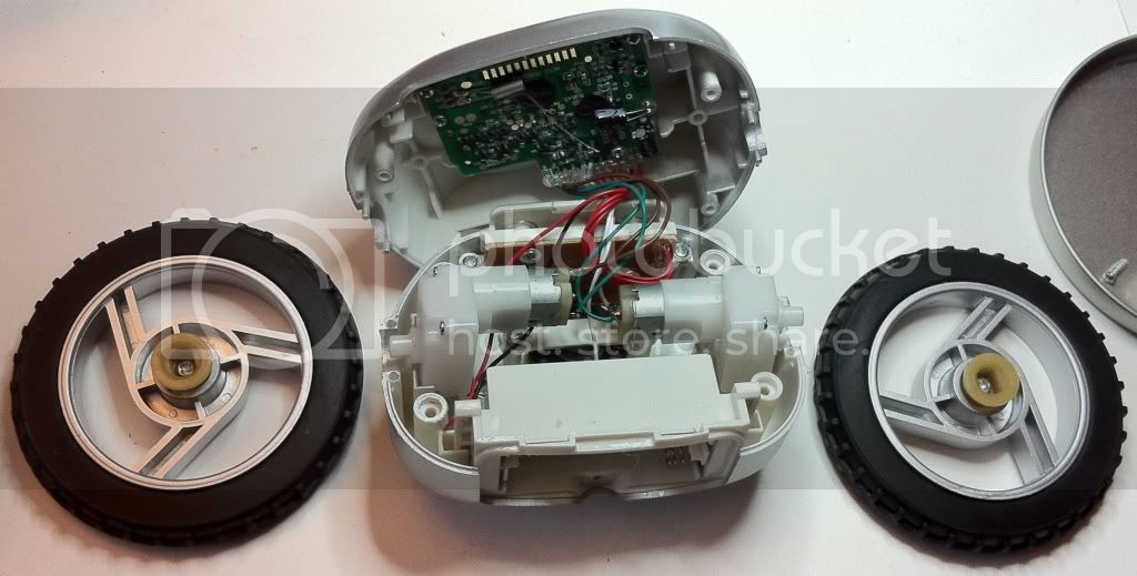

I had all this stuff percolating when I came across these little runaway alarm clocks for $2.50 in our local Staples. I took one apart finding great little motors, wheels with tires, a battery holder, and an LCD setup that looked like it would be easy to get test probes on and inject signals into.
By the way, I used to think those elastomeric connectors between an LCD and circuit board were from the devil but they're actually great for hacking. I did what I’ve done before and used little bits of post-it notes to insulate the connectors from the circuit one at a time and identify the eight segment and four backplane pins. With a scope I was able to see the typical stair-step voltages on the backplanes and segments. I drew myself many many little signal diagrams and built a spreadsheet and finally a segment/backplane diagram.
The segments turned out to be particularly easy to understand. The leftmost digit could only be 1 or blank and each of the other digits needed two segment pins: sort of for the left side of the digit and the right side. For my proof of concept I’m only actively driving one digit so I only need two segment pins.
