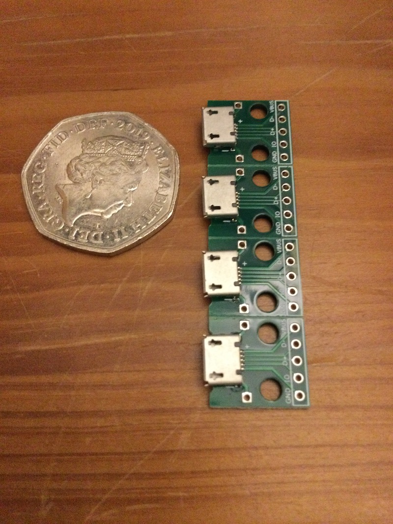

I have tried these, but i decided i will never use a circuit with just a single power limiting capacitor, better to use a schematic with one on each side of the AC input, with drain resistor each of course. In the end the size of those capacitors is such that you may as well get a proper PSU. (also the power rating ends up to be quite low, enough to drive a mosfet or a few led, but not quite enough to run a MCU.
@DrAzzy would be the one to ask,
True, but i actually had a clean windows install on my desktop and ran into some issues as well.
baffled2023:
That is 230v to 5v?
looks like 5v to 5v to me, but you can add a wall charger to get you to the 5v.
Its just a USB breakout #ReadTheThread
hehehe...
That is just, well that is disturbing. They must have forgotten to add the overloaded function for 4 shades.
baffled2023:
That is 230v to 5v
No.
A USB charger input socket.
You could mount it vertical if you want.
