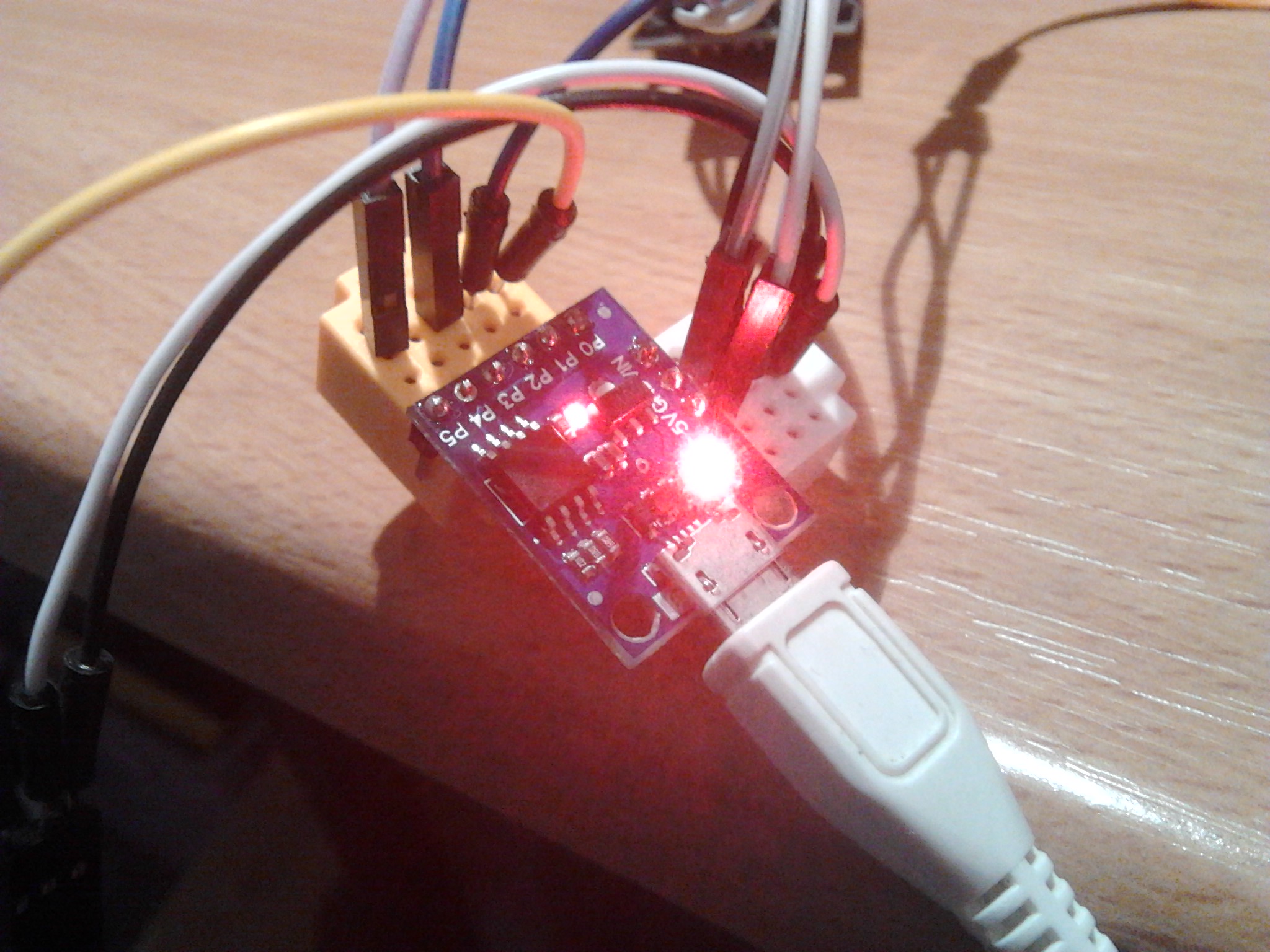

Digispark ATtiny85 micro USB module
Today I received my first Digispark ATtiny85 1$ modules (with micro USB connector, still waiting for Digispark kickstarter version -- that one can be inserted into Nanopi Neo or Orange Pi Zero USB connector directly).
Installation of board in Arduino IDE was easy following these instructions.
On first upload I ran into a well known problem, the sulution for I found in this digistump forum thread.
The blinking sketch is not named "Blink" but "Start", and I used it as basis for my first ATtiny85 "SOS" sketch: https://www.youtube.com/watch?v=sl1cAjMZYp8

  pinMode(1, OUTPUT); //LED on Model A  or Pro
  di _ di _ dit __ dah _ dah _ dah __ di _ di _ dit ___
Hermann.

No question, just wanted to post (positive) experiences with new ATtiny85 module. I thought that "Microcontrollers" forum was best match for this.
The more I look into the Arduino IDE Digispark demos, the more I am impressed. Only Due and Leonardo Arduinos support Keyboard library. But 1$ ATtiny85 does support similar DigiKeyboard library!

This is just the ATTiny85 with two mini breadboards:
The 6th pin P5 does not fit onto the 5 row mini breadboard, but P0-P4 do.
The sketch had to be modified a bit
