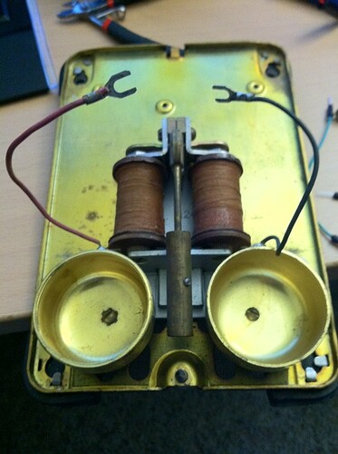

I recently received an antique phone, and would like to use my Arduino to make the bell ring. From research, I found that the phone company makes the bell ring by sending a 90V PtP AC signal at 20Hz. Is there a simple way to achieve this by using for example a FET driven by one of the Arduino's digital output pins, and connecting that to a transformer with fewer windings on the Arduino side, and connecting the windings on the other side to the bell terminals as shown in the picture?
The second circuit down in the link shows a simple circuit using a timer chip driving a n channel mosfet which is driving a step up transformer to develop the the ring voltage required. You could just change the mosfet to a logic level mosfet and drive it's gate with a digital output pin outputing a 20hz square wave.

Thanks for all the input! The Sparkfun example looks like the best documented, and I'll learn a lot from it, though the inverter solutions have lower parts counts...
One question, in the Sparkfun example schematic, they show Pin3 on the Stepup converter having a polarized 1000pF capacitor
I thought it was an error, but the datasheet shows two circuits: one with a nonpolarized cap, one with...
Am I supposed to use a regular ceramic cap in that spot?

A capacitor of that value would normally be non polarized. If for some reason you had to use a polarized cap then you would observe the polarity as shown. I would use a mica cap in that part of the circuit.

Capacitor at pin 3 define a frequency for boost up converter, in data sheet downloaded from SparkFun there is a figure 2 that help to select a cap.
" Output Switch On?Off Time versus Oscillator Timing Capacitor"
f = 1 / (t-on + t-off).
IMHO, there is a typo on figure 12, capacitor should be non polarized type, ceramic is o'k.
