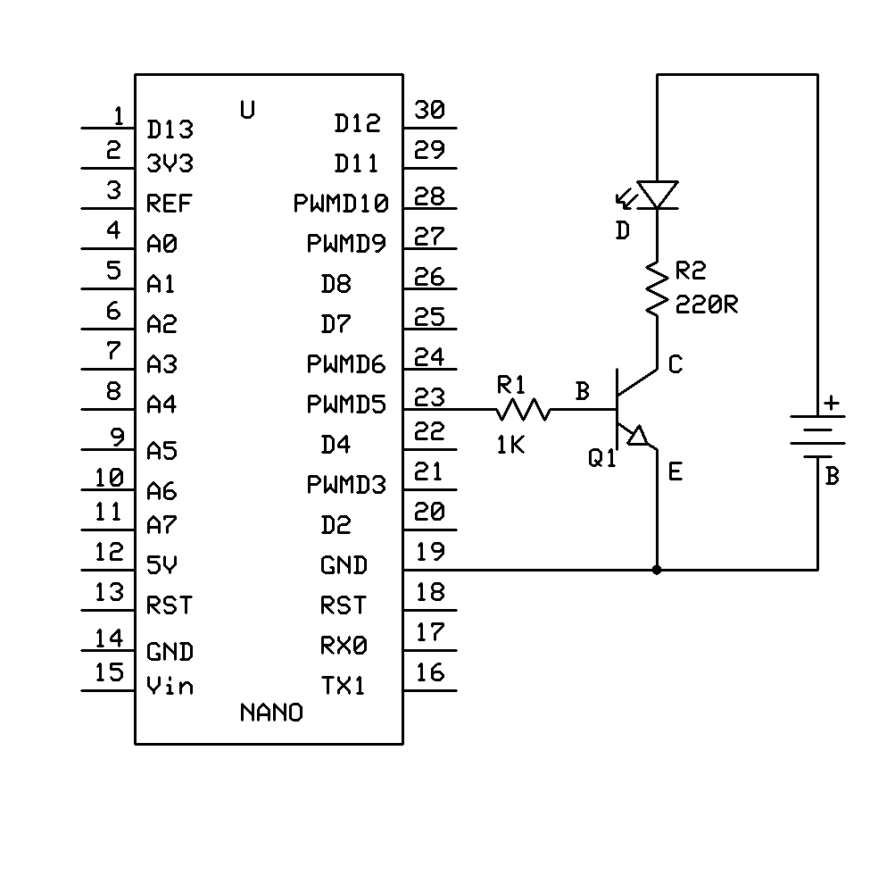

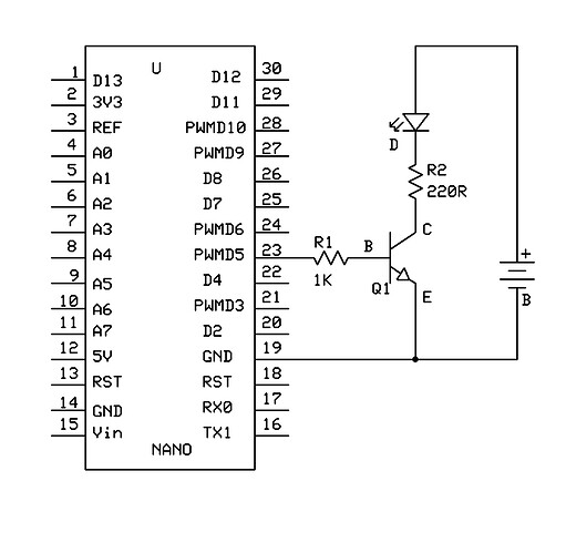

If you want to drive more than one LED per output then you will need to use a BJT or MOSFET to control the current.
Tom... :slight_smile:
