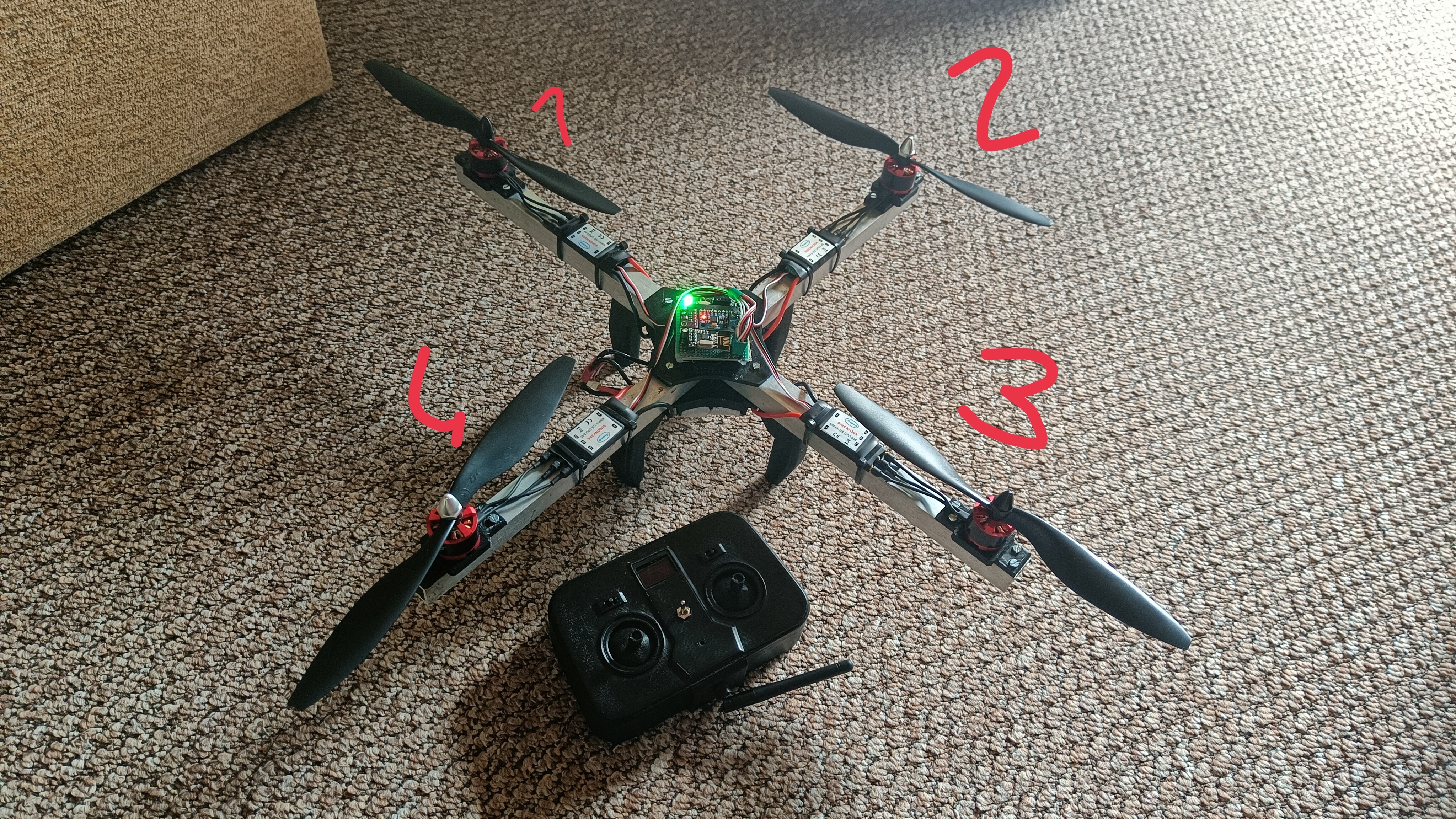

Prop spin directions incorrect. A CW proper in a CCW spot.
Prop over tightened or loose on the spindle.
Yeah, going blind squinting at the photo, so @crownous please confirm that you have the right propellers on there.

Are you spinning the props inward, good for newbies but sucks in leaves or outward good for blowing away small leaves of trees.
Where is the front of the drone? At the remote control?
which one is prop 1?
prop 1 CW
prop 2 CCW
prop 3 CW
prop4 CCW
From the photo with the remote controller as a reference. Prop1 is the lower right hand prop, prop 2 is the upper right hand prop, prop 3 is the upper left hand prop, prop 4 is the lower right hand prop.
It is highly probable that prop3 and prop4 are in the wrong positions.

So I changed directions of motors. Now I have:
Motor 1 CW
Motor 2 CCW
Motor 3 CW
Motor 4 CCW
After doing this, the drone stopped flipping over. Now after setting the throttle to around 70%, the drone starts to spin (still on the ground) and moves on the roll axis.

You do you, but there is no reason not to (and some good reasons to) just go along with numbering the motors according to the picture I posted. Which is as far as I can tell how a huge fraction of quadcopter builders do it. Kinda like using red wire for V+ and black for GND.
You haven't yet told us which end is forward, nor whether you are planning for props-in or props out.

Forward is motor 1 and 2, backward is 3 and 4.
I am not sure, if I understand it correctly. From what I read online, the difference is in spinning directions. I changed them according to the picture you posted earlier, what should be props in? So before I had props out (motor 1ccw, motor2 cw, motor3 ccw, motor4 cw).
The front pair of props should rotate in opposite directions such that the props turn towards the centre axis of the quid (props in) or away from it (props out)
The rear pair of props should do the same but should match the props in or props out configuration of the front pair
Props in or props out is a choice you must make, and the choice will need to be accounted for in the control software.
I use open source flight control software which allows for setting up the choice with a configuration tool. As long as you don't lie to it about where you CW motors are and where your CCW motors are, it will just work.
Of course the motors on the diagonal must match and there have to be two of each.

I wrote this code, but I didn't even know that something like props-in and props-out existed, so my code doesn't mention it. Why is it so important to account for the placement of cw or ccw in the code? I read on the internet that props-out is more stable for a drone like mine, what would you recommend?
pick one and go with it. I'm a learn with props blowing in for more stability and props out for more maneuverability. Being more maneuverable means less stable. What size props are being used? What size motors are being used? Props should be matched to the motors. Those motors in the image look like CineLifters, lower RPM's and bigger props. A CineLifter may warrant 3 bladed props.

The motors I use are ReadyToSky 920kv 2212 and propellers are 10x4.5 inch Link.
920Kv and sized 2212 clearly shows the motors are for a CineLifter. 920Kv means low RPM's for torque over speed. I'd use 5 to 10 inch props, depending upon the motor spacing. 3 to 5 blades props.
