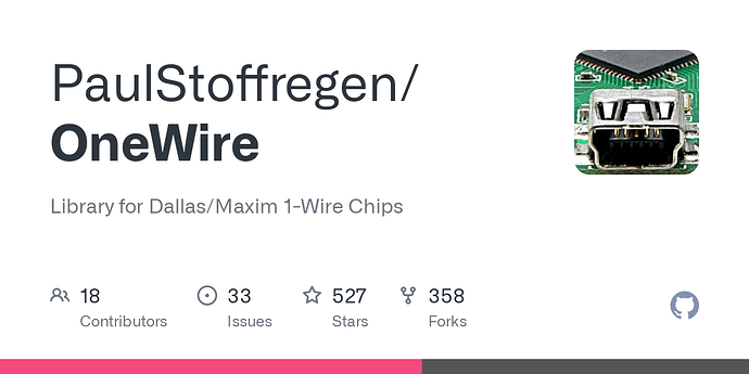

They are also here:
https://www.pjrc.com/teensy/td_libs_OneWire.html
http://milesburton.com/Main_Page?title=Dallas_Temperature_Control_Library
