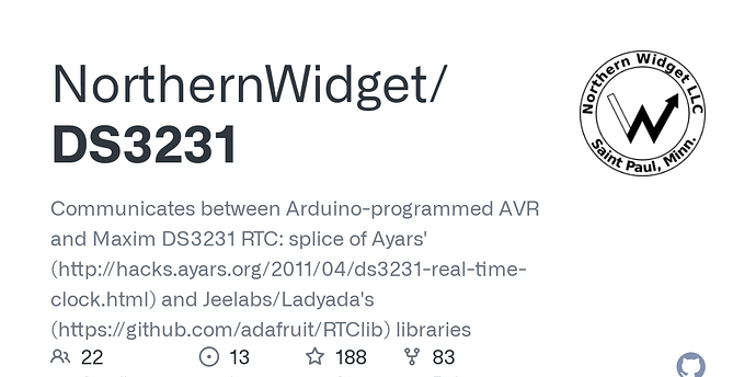

the RTC library i am using is this one

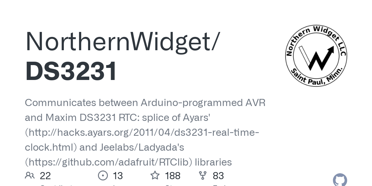

so i was able to redo the test and i actually found the issue and fixed it... it was not just EOSC.. when i changed line 114 the EOSC changed to 0 but the interrupt did not come, so that alone did not fix the issue...
But then i noticed that INTCN was also changed to 0 for some reason... so i had to go into the library and check to see exactly what is happening and there it was
void DS3231::enableOscillator(bool TF, bool battery, byte frequency) {
	// turns oscillator on or off. True is on, false is off.
	// if battery is true, turns on even for battery-only operation,
	// otherwise turns off if Vcc is off.
	// frequency must be 0, 1, 2, or 3.
	// 0 = 1 Hz
	// 1 = 1.024 kHz
	// 2 = 4.096 kHz
	// 3 = 8.192 kHz (Default if frequency byte is out of range)
	if (frequency > 3) frequency = 3;
	// read control byte in, but zero out current state of RS2 and RS1.
	byte temp_buffer = readControlByte(0) & 0b11100111;
	if (battery) {
		// turn on BBSQW flag
		temp_buffer = temp_buffer | 0b01000000;
		// turn off BBSQW flag
		temp_buffer = temp_buffer & 0b10111111;
	if (TF) {
		// set ~EOSC to 0 and INTCN to zero.
		temp_buffer = temp_buffer & 0b01111011;
		// set ~EOSC to 1, leave INTCN as is.
		temp_buffer = temp_buffer | 0b10000000;
	// shift frequency into bits 3 and 4 and set.
	frequency = frequency << 3;
	temp_buffer = temp_buffer | frequency;
	// And write the control bits
	writeControlByte(temp_buffer, 0);
when the oscilator is set to on it also sets the INTCN to 0 which was messing everything off...
changing that bit mask to 0x01111111 fixed the problem...
now interrupts work properly even on battery mode
