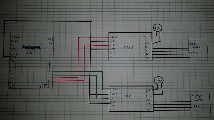

Hi all,
I'm creating a dual syringe pump which can really help out with laboratory work. The set up is simple enough: both syringes will have to move at the same speed( 0.5 ml/min) and push until stop.
My approach is to make a single pump work and then add a second one.
For this I have chosen to work with an Arduino Uno and a LCD keypad shield which will control two NEMA 17 bi-polar stepper motors(17H2a;0,4A). Both stepper motors are connected to a tb6560 3a stepper motor driver board.
I have found Arduino code for this online( In attachment) and tried to make one stepper motor work. The results where somewhat strange and my knowledge of Arduino is lacking, so I hope someone here can point me in the right direction.
Connections:
Pin 2 to CLK+ (board 1)
Pin 3 to CW+ (board 1)
Pin 4 to CLK+ (board 2)
Pin 5 to CW+ (board 2)
GND to CLK- and CW- (both boards)
12V to 24V and GND (both boards)
Result:
When I try to move stepper motor one via the LCD keypad controls, Stepper motor 2 (pin3/4) starts to move.
I know the code is for the EasyDriver but is that the reason for this behavior. As how I understand it, pin 3 and 4 should have no activity.
Can anyone advice me what I did wrong and how to solve/approach it? My end goal is to be able to start stop both stepper motors at the same time and be able to increase/decrease the speed.
Feel free to ask me for any info I forgot to provide.

You say you're using pins 4 and 5 for motor two. Your code specifies that they're being used by the LCD. That is likely why that motor is moving.
I guess it the line : LiquidCrystal lcd(8, 13, 9, 4, 5, 6, 7);
Should I then remove the 4 and 5 from this line or will this result in other errors?
If you have an LCD, you'll need to specify the pins it's attached to - do you?

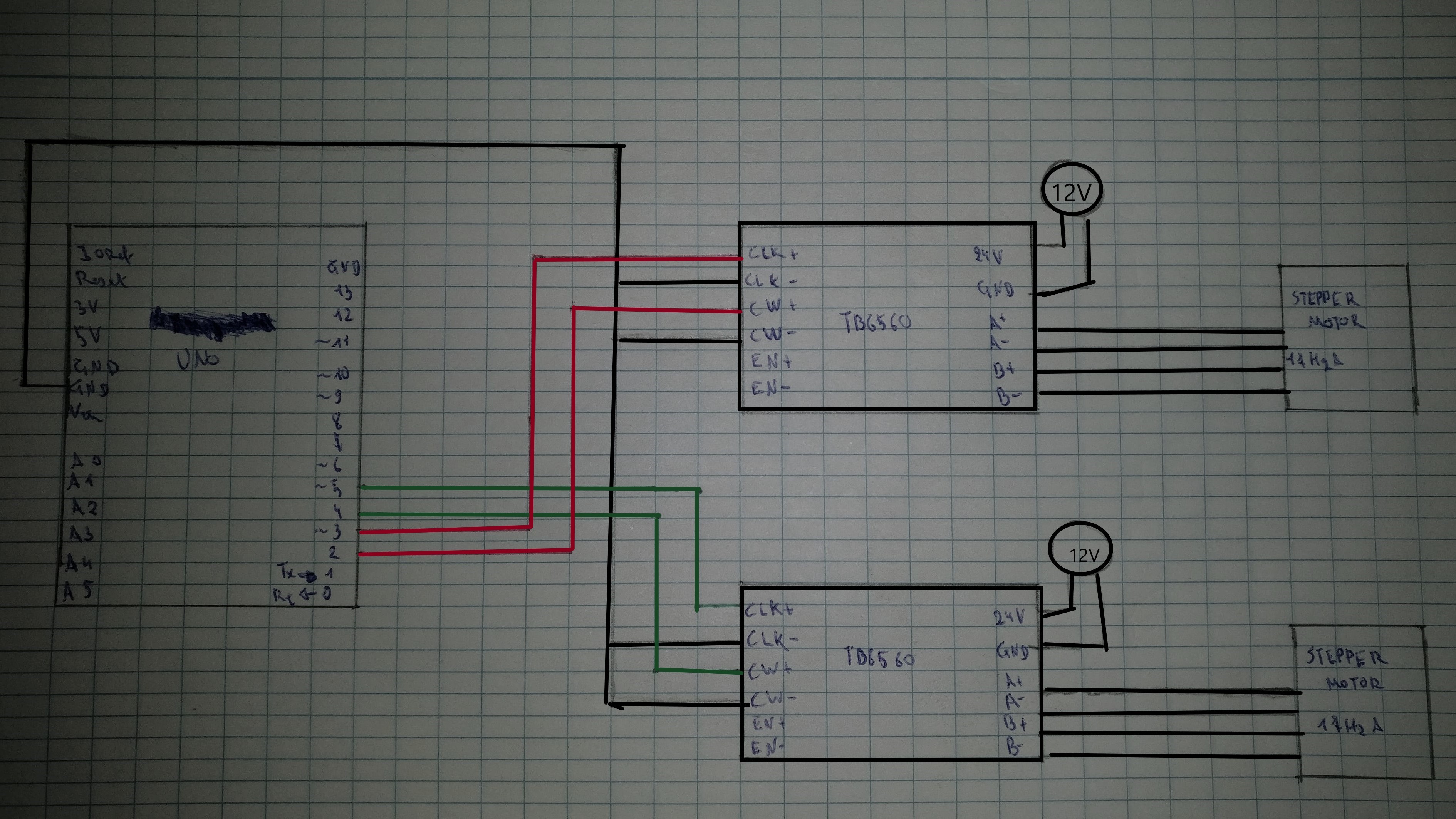

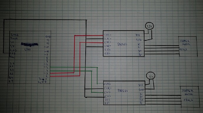

So here is my circuit, I don't really know how to draw the keypad shield since it's on top of the arduino but I have added the connections, given by the manufacturer.

What I take away from this is that the LCD keypad is connected to pins 5 to 10 and thus I can't use them.
No, the keypad uses gnd and A0 pins, it uses an analog method of reading all those buttons.
Also you cannot use pin 4 and 5 for the stepper, they are being used in the LCD circuit.
Tom.. :slight_smile:
Okay, thanks for the help.
This means that I can still use 11 to 13 for the second stepper motor?

Yes, but why?
The pins you are using now are capable of doing the job.
Sorry they are used by the LCD.
Tom.... :slight_smile:
Yes, as long as you've fixed your LCD declaration - earlier it was using pin 13.
So let's say I use pin 2 and 3 for the first stepper motor board and for the second I use 11 and 12.
These shouldn't interfere with the LCD circuit?
Based on what you've told us, yes, those pins should be fine.
Incidentally, are you seeing anything displayed on the LCD?
Yes, with the LCD keypad shield mounted, I can see the text and maneuver through the menus with the buttons. When I connected pin 2 and 3 to the fist stepper motor I can get it to move now :slight_smile:
Although it moves in the same direction for push and pull :sweat_smile:
I guess it's because I have a different motorboard driver then the person who wrote it(easydriver)
I'd drop what you have and build a very basic sketch that just moves the stepper to & fro. Best to prove you can control it without all that other stuff complicating matters. I'd remove the LCD shield too.
I got it all to work :smiley:
The mistake I made was that I misinterpreted the shield overlay. As in I connected the motor board to pin 1 and 2 instead of 2 and 3.
Now I can move towards editing the Push Pull function towards my needs(lab experiment) and add the second stepper motor.
Any tips are welcome and thanks for your help.
