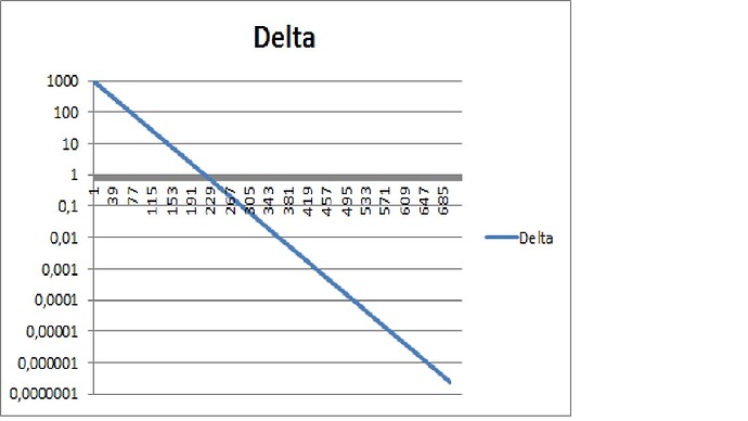

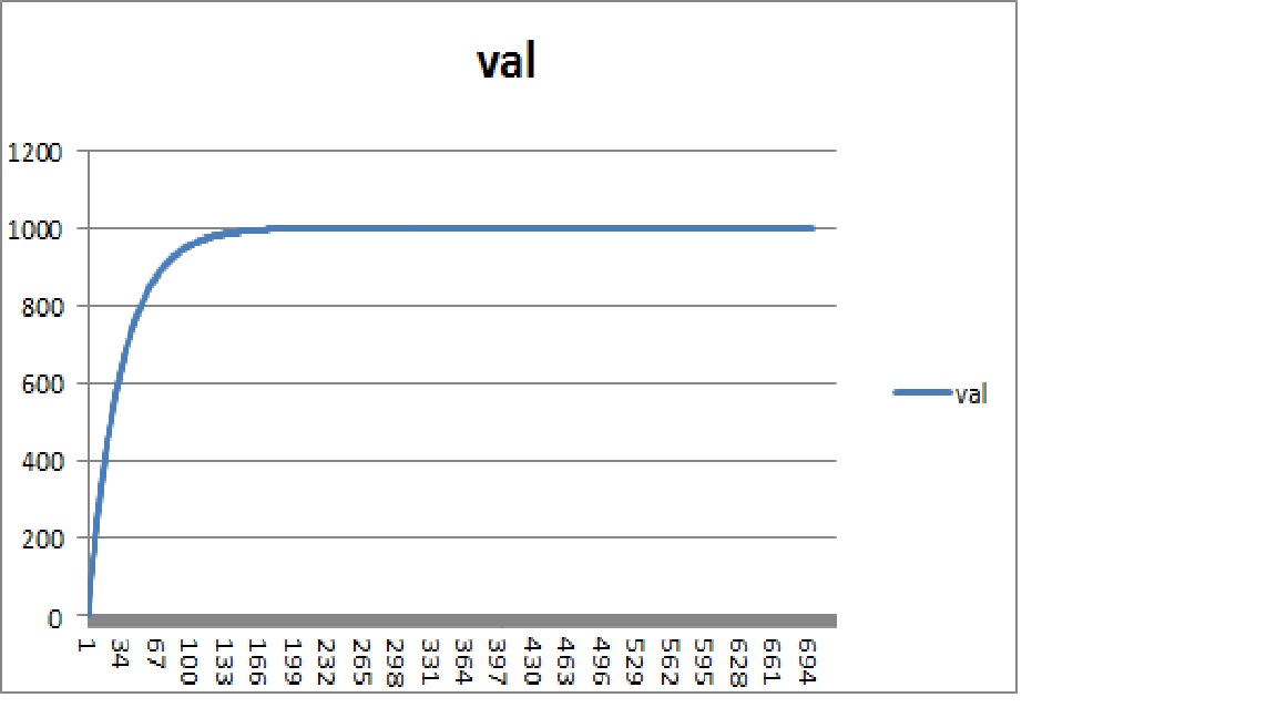

Actually it behaves more like a exponential averager. I used your code and a constant analog reading of 1000. Look at the attached diagrams (sorry for the quick and dirty excel work). One digramm ist the actual value of val which approches 1000 in an exponential manner and the other is the difference of 1000-val plotted using a logarithmic scale. As you can see the difference plot looks linear using a logarithmic y-scale therefore the function itself is exponential. I am not sure if it is possible to create a moving average filter without saving all values within the average window.

Unbenannt.jpg|1152x648
Unbenannt2.jpg|1152x648
Yes, you're right ... thanks for plotting the results.
