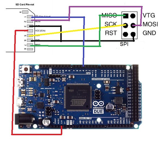

I have an Arduino DUE but I don't have a ethernet shield,
I have searched on the web how to assign a SD for playing a sound effect (I use a micro SD) and I found a picture (you can see it below) but it doesn't work (it is possible that the problem is in the code) and I don't know where I have to assign the pin. So my question is where do I put the pins (and how to assign them) on the Arduino or what is wrong with my code?

use as CS pin N°4 to work with te arduino IDE 1.5.x example.
also, other connections are bad, and probably you burned the SD card, because you connected 5V as MOSI.
use this:
and this as reference:

All SD cards and microSD are 3.3V maximum. You also need 10k pullups on
some lines IIRC.
10K pull up, are for open drain pins, as in I2C bus, in SPI there's no need of them.

what I mean is that you should only connect wires as shown in this image.
then use SD example to test the conections.
if you are using DAC as output, remember the offset of 1.65V dc, YOU CAN'T USE A SPEAKER DIRECTLY, you need to use a amplifier between the arduino and the speaker, and use a capacitor (10 uF, positive on DAC) between the arduino and the amplifier.
