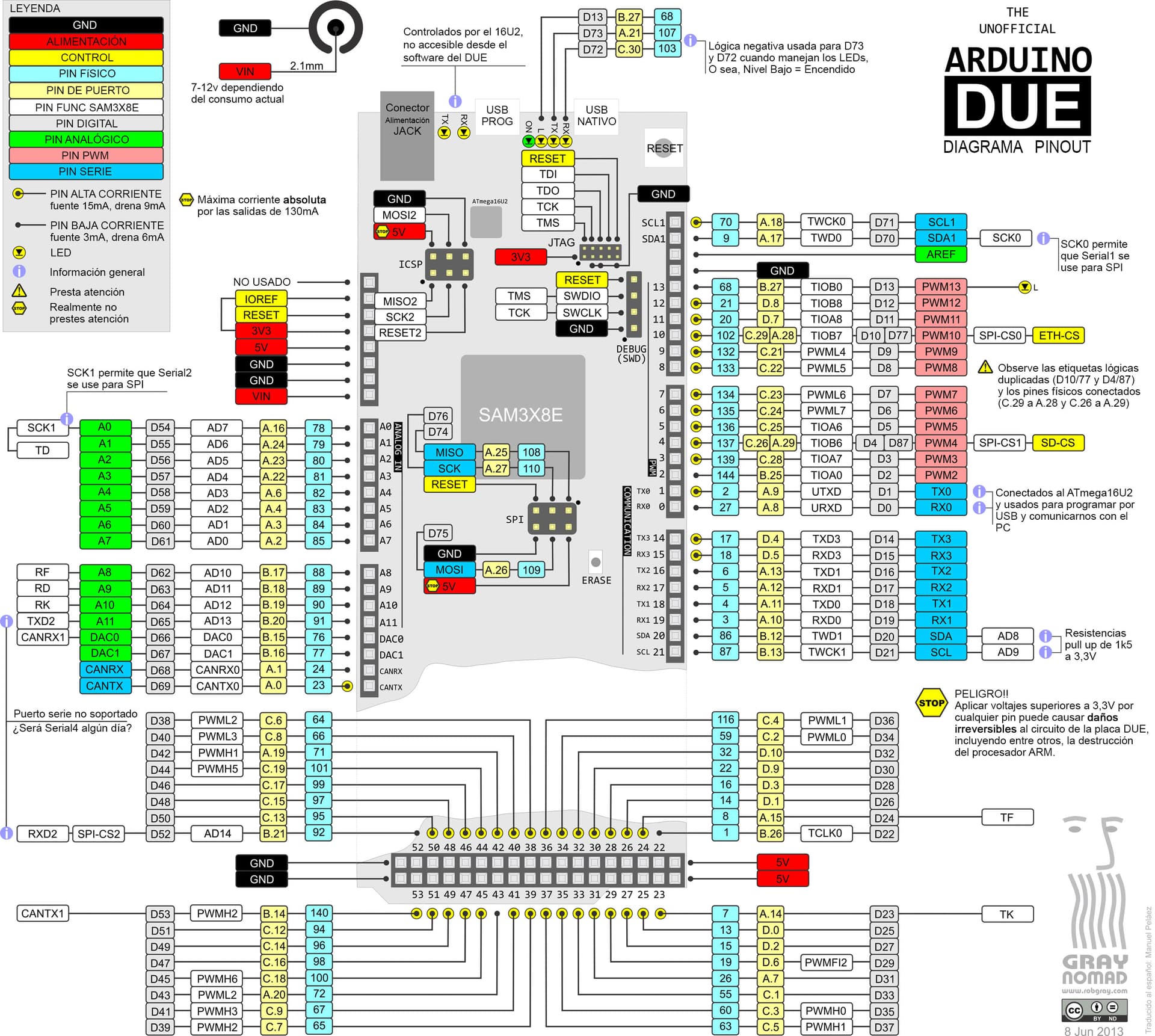

SCL1 and SDA1 don't seem to the shown on the pinout diagram above, but they are not near the reset button.
Those pins should be connected, but they are not SDA1/SCL1, they are just SDA/SCL.
EDIT:
This pinout has the pins near the reset pin labelled as SDA1 / SCL1:
This explains why they are not connected to pins D20/D21. It also means that the pinout diagram on the official Due page is incorrectly labelled!
Makes sense. Thank you. I wonder if using "INPUT_WITH_PULLUP" pin type is appropriate for SCL1/SDA1. Otherwise, I suppose a bodge is called for.
