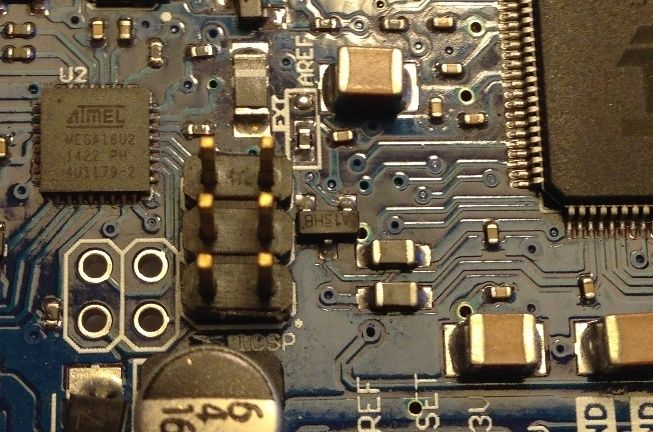

The DUE boards may be affected by the following bug: On power-on the board may start to the bootloader instead of running the onboard program, as if the ERASE button had been pressed. Pressing "reset" resumes normal operation. The bug appears to be caused by undocumented behaviour in the ATSAM3X8E microcontroller regarding the "erase" input pin - according to the specification we shouldn't ever be seeing this.
The fix is to solder a surface mount resistor (0603 size) onto the board: solder a 10k resistor between the ERASE line and +3.3V, close to fet T3. In practice, solder it across the 2 upper pins of T3.
To know if you have a DUE (or derivate/clone) that may be affected, check if fet T3 is soldered horizontally - see picture below:
(fet T3 is in the middle of the picture, just to the right of the 6-pin SPI connector)
(If your DUE has the fet soldered vertically, likely the board is more recent and good, as it has resistor R99 soldered.)

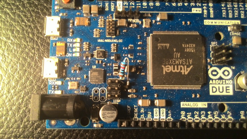

Here is a picture of a fixed DUE with a 10k resistor that I soldered across the pins of T3:
I have tested this and works fine.

According to dancombine's suggestion, I put normal through-hole 10k resistor in. Everything work correctly. The DUE start the sketch every time I put power in. Thank to dancombine. :wink:
Thank you, dancombine!! I put 10k resistor (R99 in schematics) and DUE now starts correctly.

This suggests the 10K resistor is being added as a PULLUP to the ERASE pin. Or is it actually being added between ERASE_CMD signal and GND?
The freetronics page says that the resistor was added in a later version of the Arduino reference schematic, and I can confirm that it is present in V03 of the schematics, and NOT in V02
The resistor is a pullup on the RESET_CMD signal, which goes to the gate of a P-channel MOSFET before doing anything to the SAM3X. ERASE_CMD is the signal from the 16u2, thus, it serves to hold the transistor "OFF" when the erase signal from the 16u2 is floating. It is NOT between +3.3V and the actual RESET signal!
I'm not sure how this qualifies as "undocumented behavior of the chip." Seems like a simple bug (probably in the 16u2) to me. It'd be nice if the sites advertising fixes went into more technical detail (including a schematic/circuit description of the fix, and not just physical photographs!)

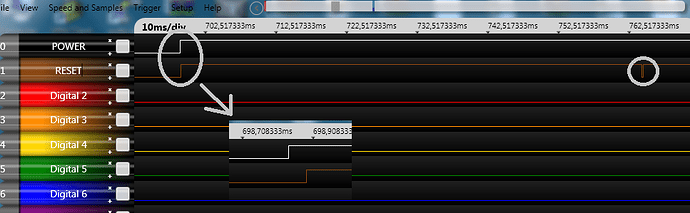

Yes. The author said that RESET will be LOW for some usec after power on.
However in some msec I see one more RESET :slight_smile:
But it doesn't metter. More RESETs - better for SAM3X )))
I'll have to admit to being skeptical that the patch changing the power-on reset behavior will have any effect on the "doesn't start sketch after upload" problem that occurs long after power-on...
The thread surrounding the 16u2 patch describes a somewhat different problem than this one.
(Oh; that IS the subject of this thread, isn't it. My Due Clone won't start the sketch after upload, either.)
