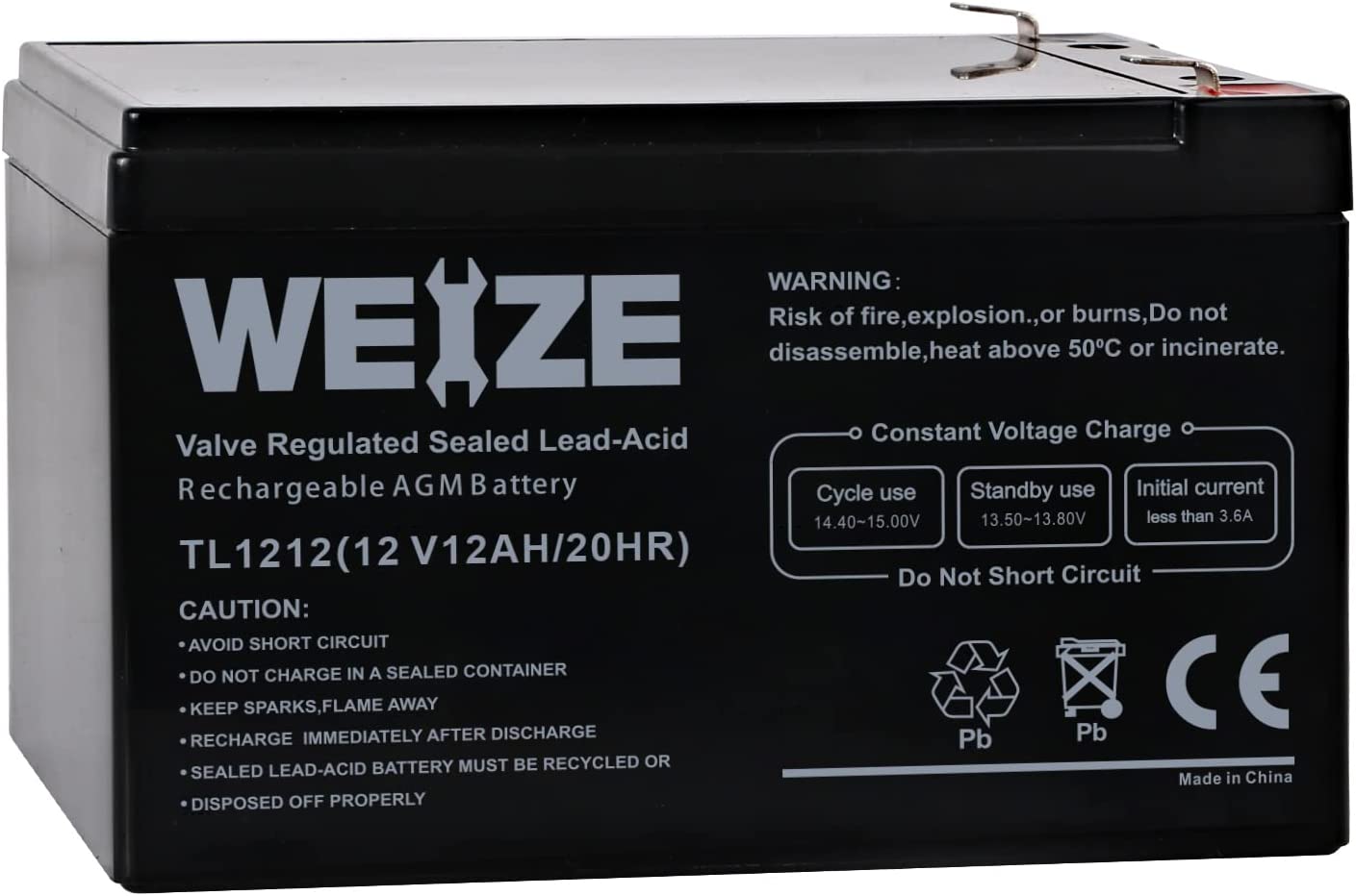

Back-up battery. Have it last for an hour or so, should be enough in that kind of situations. Allows regular lock/unlock while mains power is out; unlocks when battery runs out.

I was thinking of getting a few of these... a lot of wire, drop-down VR to 5v, charger circuit, relays, fuses, two MCUs, CTs, voltage readers... what do u think?
Cheap, bulky, heavy, reliable. A good old lead/acid battery.
