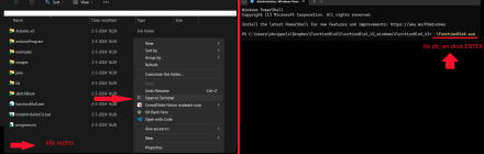

Hi, me again.
I am still having a problem with the exported folder. I am using coworkers' PCs during breaks to test the folder.
The program does succesfully find com-ports. And the the upload program buttons works well on my own PC.
But on the other computer, it just won't work. I believe the problem lies in my install batch file.
I am currently trying out this batch file to initialize arduino-cli

Had to make a picture of the dump unfortunately/
That path behind the 'config file written' line is correct.
platform arduino:avr@1.8.6. already installed.
It claims that the core is already installed (I ran the file more than once)
and dito for the servo library.
Yet when my application "FunctionBloX" tries to build I get this feedback:
Platform 'arduino-avr' not found.
What I suspect is that the the 2 SET lines of my batch files aren't working.

These will only set the environment variable within the scope of the batch file. If you later use Arduino CLI from a different scope then that environment variable won't be set. This is a problem because the arduino-cli config init command wrote the configuration file to the data directory so if the ARDUINO_DIRECTORIES_DATA environment variable isn't set the Arduino CLI won't use the configuration file and will instead use the default configuration and thus the default data directory location. The arduino-cli core install arduino:avr command installs the arduino:avr platform to the data directory, so this is why Arduino CLI doesn't recognize that installation anymore.
