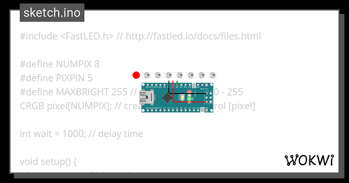

Here's a toy to play with...
And here is a small sketch to get you going on WS2812...

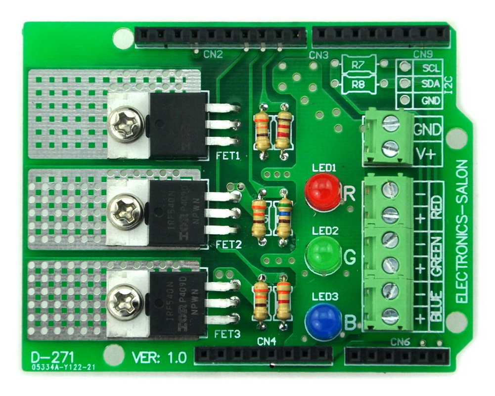

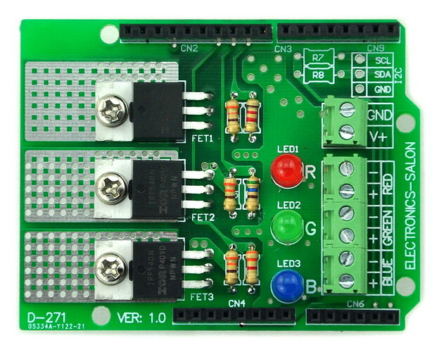

Do you need/want to have the possibility of every LED being a different colour and intensity?
If yes, you need the Arduino, the strip and a power supply of sufficient capacity for the strip and some minimal extra for the Arduino.
If al the LEDs are always the same colour and intensity, then you nee d dumb strip and three channels of a simple driver circuit, for which modules can be found, and that power supply... of sufficient capacity for the strip and some minimal extra for the Arduino.
If accurate real time of day is important, you'll need to add a simple RTC "real time clock" module, these are fairly easy to use, inexpensive and there are a crap-ton of examples sketches.

WS-2812B LED strip (ranging from 30 LED's per meter, to 144), an Uno, a 330 ohm resistor and an appropriate 5V power supply is all you need.
Using the FastLED library, changing the intensity is as easy as setBrightness() at the appropriate times.

I don't suggest buying this, it's just a plausible module that showed up googling:
Very probably overkill, very probably able to handle most RGB strips. You'll still need a power supply (wait for it) of sufficient capacity for the strip, here the voltage needn't be the aource of power for the Ardiuno, so you can shop 5 or 12 or 24 volt strips for aesthetics or price.
