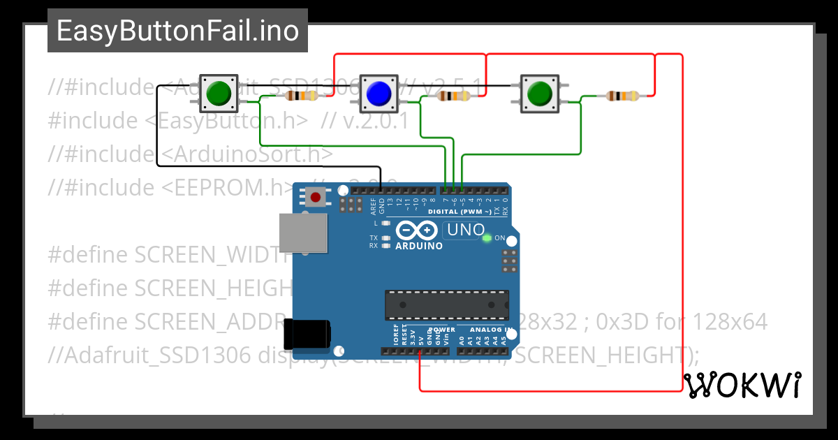

Tested with a simulator, you can play with it yourself too.

I webt to some trouble (fun!) to make an executable sketch out of your heavily redacted code.
See it, play with it here:
The problem is in the code you haven't posted. Or in the wiring which you haven't shared. Hint.
a7

Did you take my link, run the code you (mostly) wrote and observe that yes, shirt and long press events are fine? Go do that now if not. There is nothing like a real test, even using a simulator. :expressionless:
The hint was just to make you realize we need to see a schematic. "a7" is how I end a post, short for @alto777. Sry.
EasyButton is fine. Demonstration of your intended use deployment works well. The schematic looks, at a glance, plausible, but may have an answer.
