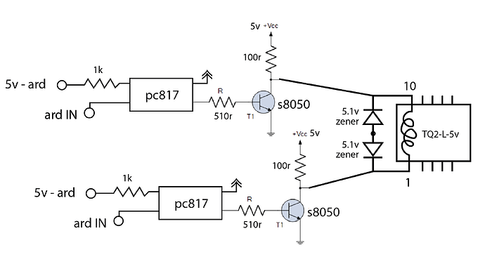

Hi everyone! I have a project that I'm sort of working backwards on... I started it 7 or 8 years ago, and am finally getting to finishing it up. I'm good at understanding and figuring out, but am a total noob with code.
Using an Arduino Mega, this project uses 9 DPDT single coil latched relays to create 9 "loops" to effect pedals when engaged, and just have the audio pass through when not engaged.
I found the initial code in an instructable - and it works! But it used the Arduino relay modules, which I'm not using - I've created my own relay setup using TQ2-L-5V relays. To engage the relay, it needs positive to one side / negative to the other, but to disengage the relay, I have to flip the voltage. I've attached my method for doing that, which utilizes a transistor setup for NOT gate. (I've attached that schematic). I've tested that, and it works.
My issue is that the code, as is, which uses the keypad library/setup and sets each relay's status from EEPROM preset, only has one pin for engaging the relays. (In the code, lines 100 to 107 are where the relays are engaged, I think).
void readPreset(int addr, int pcNum, int led)
  for(int i=0; i<numberOfPedal; i++)
    digitalWrite(relayPin[i], EEPROM.read((addr)+i));
    digitalWrite(ledPin[i], HIGH);
    digitalWrite(ledPin[led], LOW);
  midiProg(0xC0 | midiChannel , pcNum);  /* send midi change program 1 */
With my relay setup, I need a "resetPin" to go HIGH while the relayPin goes LOW - and I'd like that to be more of a "pulse" - 100ms maybe; enough to engage the relayPin LOW (then HIGH after 100ms) / resetPin HIGH, and when it's time to disengage relayPin HIGH / resetPin LOW (then high after 100ms).
I hope that makes sense... Basically, instead of one pin for the relay just being ON - I need it to pulse on and then off - and I need another pin to work opposite the relays.
Any thoughts? I appreciate it in advance!

Interesting that should work with the correct values. If you have a higher voltage available for the relays that would help as you will get less then 5V because of the drop across the 100 Ohm Resistor.
it's easy enough to turn one of 2 pins ON for 100 msec

Wouldn't it be easier to use the TQ2-L2-5V relays with the 2 set and reset coils? 1 pin turns it on and the other turns it off.
I understand the benefit of using a latching relay. And of course you have the ones you have, which are single coil.
Either single or double coil latching relays will obvsly need more pain to deal with than one regular non-latching.
I assume that to get the relay in one state you write HIGH to one of the driver circuit sides and LOW to the other, and vice versa to toggle it back. Otherwise both sides are LOW and the relay doesn't change.
For now let's also say you have enough output pins to do this directly.

It would cost about $30USD to replace 9 TQ2-L-5V with the TQ2-L2-5V. The simple solution.
Or you could use an H-Bridge such as the L298 or roll your own similar to
Alto777 has the logic right (I'll reply to the other posts shortly - thank you to everyone that posted, this has been very helpful)
I have some questions first, hehe...
Correct - a complete reversal is needed. It only engages when the voltage is inverted - 5v+0v to engage, 0v+5v to disengage. Once the relay is engaged, it will stay in that state until it's disengaged, so I don't have to have constant power to it - just enough to switch it on, and then just enough to switch it off.

So in the code you made above (and, btw, THANK YOU for taking the time to do that!), is the switchRelay something that works whenever left pin is engaged in the code I already have, or does this code replace my EEPROM.read code in some fashion? I'm just trying to understand the logic and am somewhat noob-ish on this stuff.
Regarding the delay - yes, 100 is very conservative. While I'm testing with LEDs, it's very long - like 1000 - so I can see that it's functioning. In situ, I would be decreasing to probably 10ish to ensure enough time between the OPTO and NOT gate engage.
Let me know about the above when you get a moment - again, thank you so much for the reply!
(as for why I have all these relays - I built a pedalsync system and it was not quite right. I have all the parts needed for this and would like to use them if I can. The Opto/NOT gate circuit works well and gets me about 4.25v, while the relays only need 3.75v to engage, so I have a good buffer there while not taking too much mA (I think around 50 per relay). Regarding needing an extra pin for each relay, I have plenty of pins on the Arduino, so I'm not concerned on that front).
My function is… agnostic. It neither can know nor care who is calling it with what arguments.
So the above, which presumably ends up writing HIGH or LOW to one relay pin, can be directly replaced with
    switchRelay(i, EEPROM.read((addr)+i));
provided you have arranged the ledtPin[] and rightPin[] arrays to hold the appropriate real pin numbers.

This is true, but I already have what I have - While $30 for new ones isn't gonna break the bank, I wanted to see if I could use what I have. I think it's technically the same number of pins and same setup for each relay with the TQ2-L2, as well. I was able to get it figured out with the relays I have for now, but if they don't work in actual testing, I may be getting the TQ2-L2s soon.
Benefit to that is I wouldn't need to convert anything to 5v (could just get the TQ2-L2-9v), but we'll cross that bridge if/when necessary, hehe.
This is so thorough! I'm not sure how to finagle this in with what I've done - unless you're suggesting this replaces the keypad stuff I've been working with?
I was able to get what I needed working, but I think I need to study this code to learn a bit more in-depth about this platform!
My 5v signal from the LM7805 is 5.8v - when it goes through the 100r and into the coil, it's at about 4.25v. The minimum to set and reset the relay is ~3.75v, so I have a little wiggle room depending on my power source, and it's pulling about 50mA per relay.
the MAX voltage for the relay is 7.5v, so it could handle more voltage, but I think it's good where it is for now!
