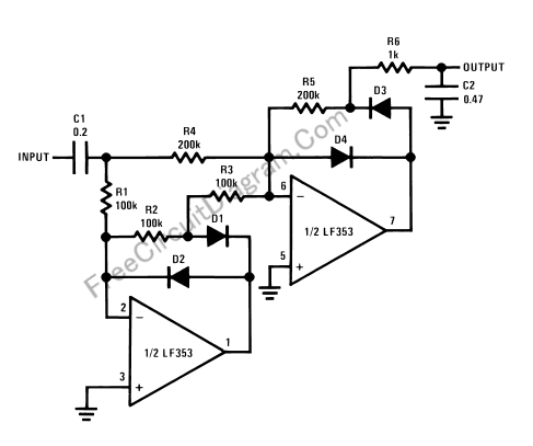

To simplify the code in the Arduino, I'm thinking about following the preamp socks123 suggested with and "envelope detector", like this one:
I'm hoping this will make it easier for the Arduino to distinguish between the gunshots and other noises by letting it focus on the overall amplitude, instead of the amplitude of individual cycles.

Stumbled across this thread, thought I would post a somewhat "proper" solution, for any in the future who come across it.
Basically, you want to do 2 things, you want to rectify the signal, and you want to boost the signal.
Rectifying, will take the negative voltages and make them positive, and boosting... well that is kind of obvious.
For anyone looking for a specific noise, like a gun shot or a hand clap, these noises always fall into the same range of sound. So we will use a band-pass filter to cutout any other noises. Coupled with the rectifier and booster. We can effectively use an analog input as a true/false, true being any value greater than say 1.
While this is true you want to do it the other way round. You amplify the signal first otherwise you don't have enough signal to get you over the 0.7V forward volts drop of a diode.
That's only full wave rectification you need 4 diodes for that as opposed to one for half wave. You only need half wave for this sort of application.
If you want to use a filter then this goes between the amplifier and the rectifier.
