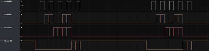

We need some help decoding the scanning protocol for a vintage electric typewriter. My students got an old electric typewriter at Goodwill for $10. We found that the keyboard is controlled by two rows of 12 pin headers. The two headers form two sides of a matrix. We were able to decode the matrix and can cause the typewriter to type any key (or key command), by shorting a pin from one of the rows with a pin from the other row. So far, so good.
The problem is that now we want to control the keyboard ourselves. Using a scope we have tested every pin on both rows there are no pulses on either side. Some pins are permanently high and some are permanently low. So how the heck is the keyboard scanning?

The 74LS145 is a BCD (binary coded decimal) decoder/driver with open-collector outputs. It takes a 4-bit BCD input and outputs a LOW on one of ten outputs. I would guess that is being used to scan the keyboard matrix. Check the input lines of the 74LS145 to see if you are getting a sequence of BCD numbers, that would at least let you determine the scan rate. I would suspect there may be pullup resistors going to CN2, with CN1 connected to the 7LS145, so that the key line is pulled LOW on CN2 when a key is pressed.

We recorded the four inputs to the BCD on a logic analyzer. The image below shows that indeed the keys are being scanned. We tracked the outputs which all go through a reverse diode (for protection I assume) to CN1. Again, you were correct, the CN2 pins go back to the microcontroller with pull-up resistors. Since the BCD is an open collector as you mentioned, we will try adding 10K pull-ups to CN1 and track it on the scope.
