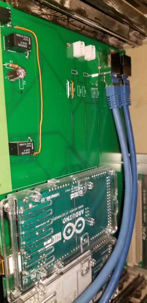

In the machine, and not on my desk, I have the addition of electrical motors and high voltage wires that make matters worse.

The wiring is done via direct pcb header ot thru a short patch cable, Cat 6 with shielded ends. In an earlier version I had used USB cables and found out that the I2C signal degraded rapidly.

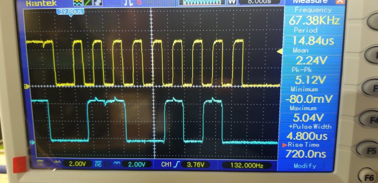

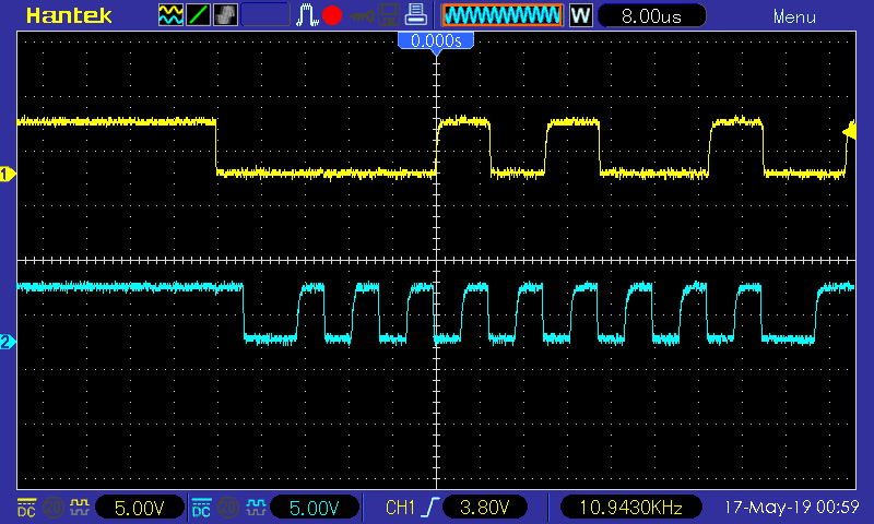

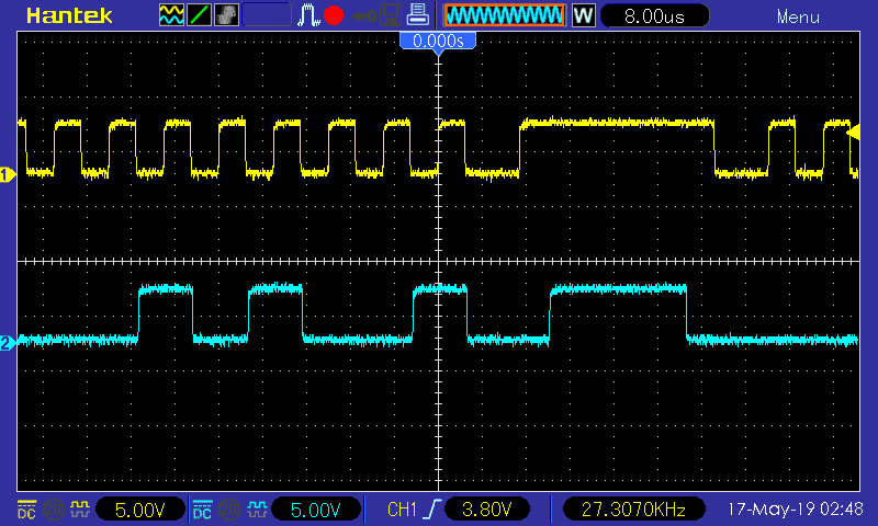

Here is the I2C running with nothing..no pull up resistors..just a bare Mega

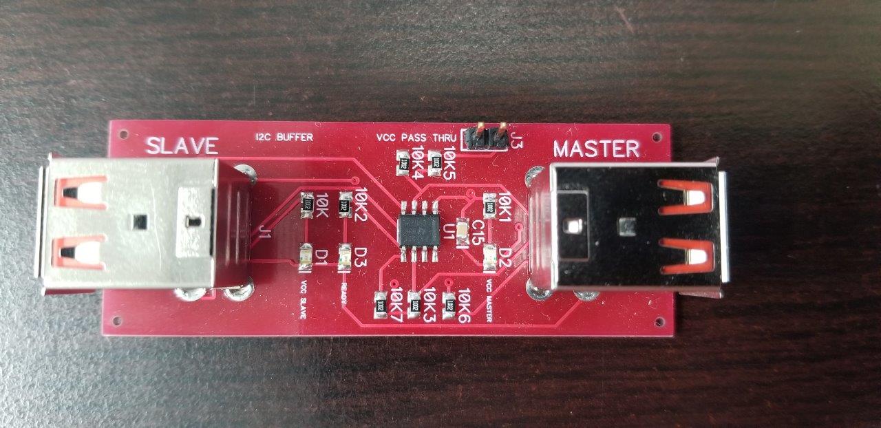

I had whipped up this I2C buffer board. It uses the TCA4311A hot swappable buffer chip and it does a nice job of keeping the master isolated.
The waves don't look too different though.. a little sharper...
...another looks with a 2 volt scale.

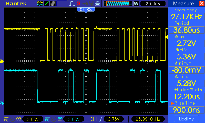

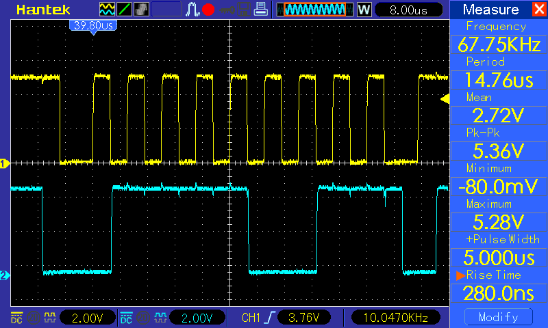

Just adding to this post.. The eeprom I have spoke of that works at my desk (very well) but runs like a bag of poop on the machine exhibit nearly the identical I2C wave (more links to pictures) have me a bit concerned that I may have more than one issue. I am going to attempt to sharpen my signal. I have 3.3k pull up resistors installed at the moment.

Ok.. Here is what I found..
The eeprom that I was trying to use was the main issue and not the wires.
It had A0, A1, and A2 set low for addressing. A hex 0x50. ..and one of my many nano slave devices was address (80). I had a conflict.
I set A0 to high on the eeprom to make it 0x51, or 81 and my I2C network was stable.
The static and other electrical issues may again return, but for now, I am going to take the win and run.. lol
