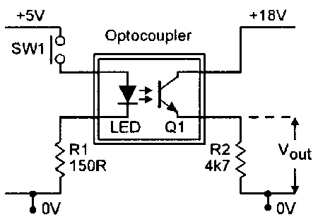

That means that the load resistor (R2) minimum value is 1.6K (80V / .05A). In practice it would be much higher.

FYI, current is a function of voltage and resistance (V = I x R=> I=V/R) 18v/0.05A = 360 ohms. It is usually best not
to operate a device at the maximum ratings so a higher resistance would be used, (ie: 390 to 470), but if all you need is a logic signal then a 4.7k ohm resistor is used. The reason it is connected to GND is that the designer does not
want to invert the logic. Normally the pullup resistor on the collector of an optocoupler would be be connected to
+Vcc, but this results in a logic inversion because the transistor pulls the signal low when the led is on. If this logic
inversion is inconvenient, the designer puts the resistor from the emitter to GND as shown in the image, thus
resulting in 1:1 logic translation. (led on = H output signal)

Yes, the resistor limits current (when the transistor is on) but it's also required because you essentially want a variable [u]Voltage Divider[/u] where one-half of the voltage divider is a transistor instead of a resistor.
A voltage divider works because of Ohm's Law, plus the fact that the same current flows through series components (one of Kirchhoff's Laws). The voltage gets divided with more voltage "across" the higher resistance.
When the transistor is off it has (nearly) infinite resistance so the voltage is across the transistor with (almost) no voltage across the resistor, and (almost) no current flows.
When the transistor is on it has (nearly) zero resistance so (nearly) all of the voltage ends-up across the resistor and current flows.

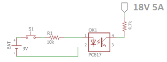

I drew this basic circuit diagram and have question about it, see attachments.
Question:
  • If I add 4.7 Ohm will it help protect the collector & emitter?
  • You see the arrow symbol of collector and emitter at most transistors that is conventional flow?
Yes, but...
But your schematic shows 4k7 and your question says 4R7. 4k7 is reasonable, 4R7 is not.
But you need a resistor anyway so there is something to develop the output votage across. Without it the collector is tied to 18V and the emitter to 0V, no possibility of any change on the output.
