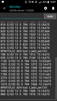

Sorry for reviving an old thread, but I just did this:
Would welcome constructive critics
