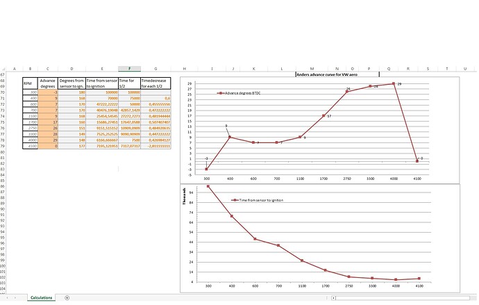

Ok Dwight, I am greatfull for your words. I am having a little hard time understanding the math, but I will try. I feel that it will be difficult for me to change my code that much. I have been working on this code for 6 month now and I would love to get it function. Could you study my code and see if it could be modified in some "easy" way?
You can see my advance calculations in the attached excell file (the numbers don`t match the code just now, but I will uppdate the code).
The engine is an experimental aircraft VW type1 engine or an airboat VW engine. The aircraft engine is operated in a slow and easy manner. When flying, you push the throttle slowly and cruse at 3000rpm, and land at 1000 rpm. The engine is cooled ba the propeller and ram air baffles. Most don`t use oil cooler in this engines (1835cc, 65hp @ 3300rpm)
I dont have any cam sensor, and I dont need it. There are two magnets and one sensor and two coils (Wasted spark coil pack). The magnets are positioned at 3 degrees ATDC and the advance timing is set at 3 degrees ATDC so that it will be possible to hand prop the engine.

I have not hade the time enought to work on my code a lot, but today I did. I have tried to get rid of the unnecessary calculations and I made an attempt to use crankshaft time instead of rpm. I did make an curve in excell for the cranktime also to get a better understanding. Please have a look at my code and excell sheet.
I have some questions.
First, I have read that calculation with global variables take a lot of memory. I have to use them in my interrupt service routines and interrupts, but in my loop I could move that value to an local variable and use that in my calculations in the loop. Is that a good idea?
The ignition advance time could be coded with about 10 calculation instructions. It could also be coded without calculations, but a lot of if instructions instead (one for every 100rpm for example). What way is the best? What takes most time, and what is most safe/realiable?
Here is one version:

And here is an other wersion (the one I use for the moment):
//Following calculations are based on a excell sheet with the advance curve attached.
 halfrev= halfrevGlobal; //Transfer global variable value to a lokal for less memory usage ?.
if ((halfrev<= 100000)& (halfrev>= 75000 )){ //Advance from -3 to 9 @ 300-399 rpm
cranktime=(halfrev+600/1000)-dwellTime;}
if ((halfrev<=  75000 ) & (halfrev> 50000 )){ ///Advance from 9 to 7 @  400-599 rpm
 cranktime=(halfrev+456/1000)-dwellTime;}
if ((halfrev<=  50000 ) & (halfrev> 42857 )){ ///Advance from 7 to 7 @  600-699 rpm
 cranktime=(halfrev+472/1000)-dwellTime;}
if ((halfrev<=  42857 ) & (halfrev> 27273 )){ ///Advance from 7 to 9 @  700-1199 rpm
 cranktime=(halfrev+482/1000)-dwellTime;}
if ((halfrev<=  27273 ) & (halfrev> 17647 )){ ///Advance from 9 to 17 @  1100-1699 rpm
 cranktime=(halfrev+507/1000)-dwellTime;}
if ((halfrev<=  17647 ) & (halfrev> 10909 )){ ///Advance from 17 to 26 @  1700-2749 rpm
 cranktime=(halfrev+485/1000)-dwellTime;}
if ((halfrev<=  10909 ) & (halfrev> 9091 )){ ///Advance from 26 to 28 @  2750-3299 rpm
 cranktime=(halfrev+447/1000)-dwellTime;}
if ((halfrev<=  9091 ) & (halfrev> 7500 )){ ///Advance from 28 to 29 @  3300-3999 rpm
 cranktime=(halfrev+427/1000)-dwellTime;}
if ((halfrev<=  7500 ) & (halfrev> 7317 )){ ///Advance from 29 to 0 @  4000-4100 rpm (rev limitation)
 cranktime=(halfrev-281/1000)-dwellTime;}
Wich way is the best for my application?

Here is the advance curves. Excell file was to big.

Maps are also a convenient way of thinking about the engine parameters. If you need to tweak the advance a little at 1800rpm, then you can do that directly, without trying to work out the coefficients of an equation that does this.
One thing I wanted you to see was that the amount in micro seconds
advance was almost a constant except at the ends. At the high end
it rolls off to help keep you from over revving.
At the low end, it is to ensure that it doesn't kick back and damage
the starter motor.
