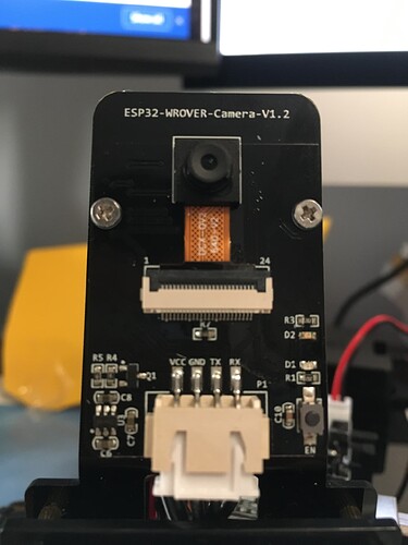

Elegoo Smart Robot Car V4 cannot upload ESP32-camera code

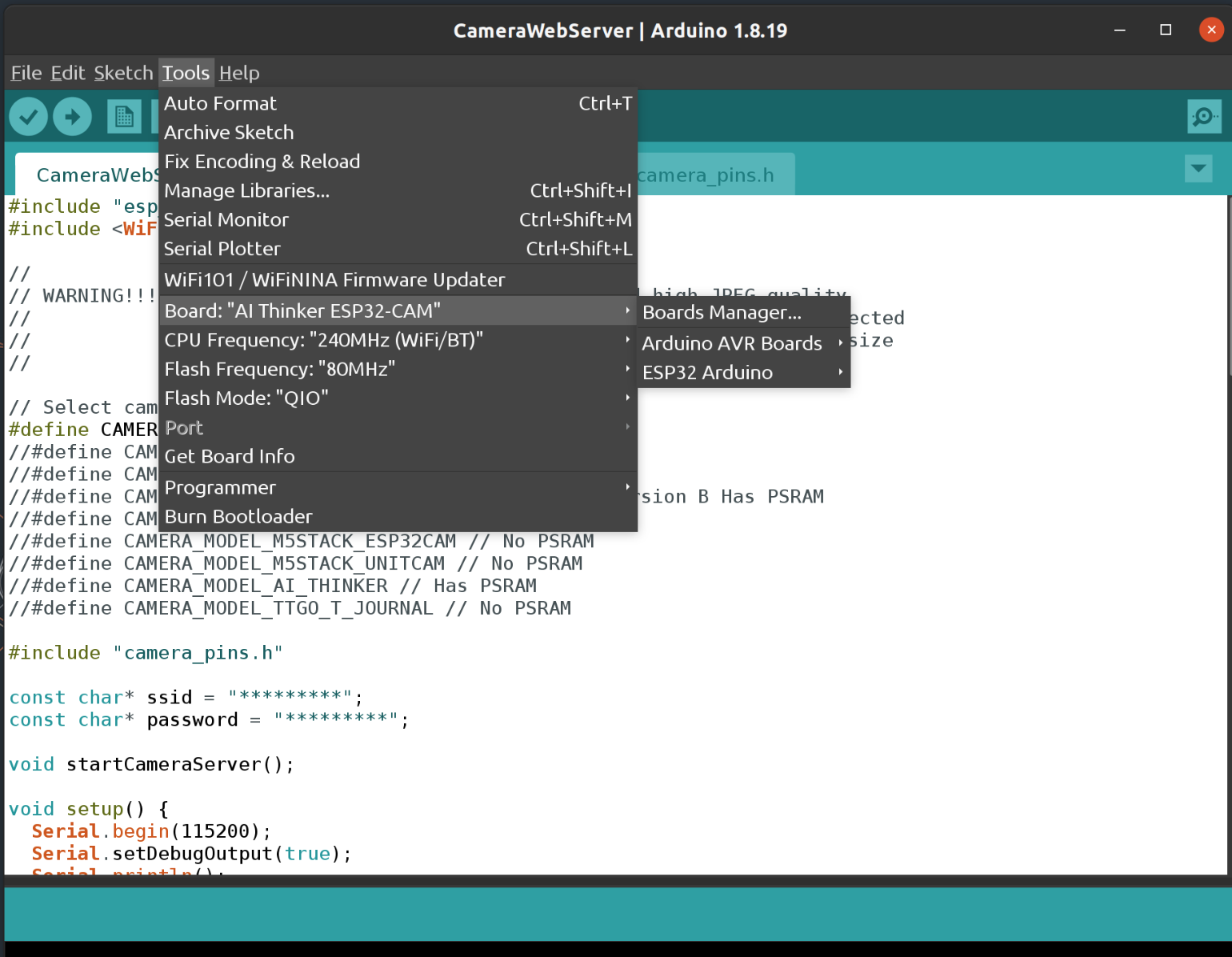

config in Arduino IDE:
install library: ESP32 (2.0.2)
board: AI-Thinker ESP-CAM
port: /dev/ttyCAM0

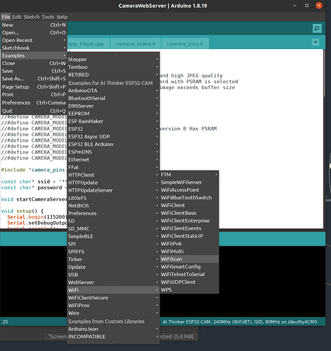

example code:
WIFI--WIFI-Scan
build:
success
upload: (output as below):
Sketch uses 794025 bytes (25%) of program storage space. Maximum is 3145728 bytes.
Global variables use 53908 bytes (16%) of dynamic memory, leaving 273772 bytes for local variables. Maximum is 327680 bytes.
esptool.py v3.1
Serial port /dev/ttyACM0
Connecting........_____....._____....._____....._____....._____....._____....._____
A fatal error occurred: Failed to connect to ESP32: Timed out waiting for packet header
What I did:
  1. press and hold the switch button down when "uploading ..." starts. The switch button is the only button I find on the ESP32-WRVER-Camera board. (same error message like above) (I did some research and find somebody suggests it to fix the issue).
  2. try the same process in Linux and Mac OS. (same)
PCB diagram:
some references:
Press the button before uploading the code. On screen Waiting for upload should appear, then upload the code.

Images of the ESP32 wired up?
Oh, did you, as per the examples/instructions you linked, short the programing pin to ground?
I use the default ESP32 wiring from Elegoo Smart Car and did not short the programing pin to ground.
I thought Elegoo already did so (short the pin to ground when uploading the code to ESP32-CAM).
Should I short pin GPIO 0 to Ground when uploading code?
I've uploaded the code via MicroUSB in the ESP32-CAM board. The USB in Smart Car Sheild I used is not for ESP32-CAM.
