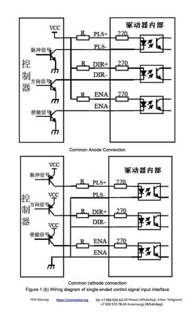

This HSD57 manual suggests:
...and the common cathode is more like your program seems to be is written for.
If you've got it wired like common Anode, the pulses will be inverted. Switch your HIGHs and LOWs for Common Anode
or active-LOW wiring.

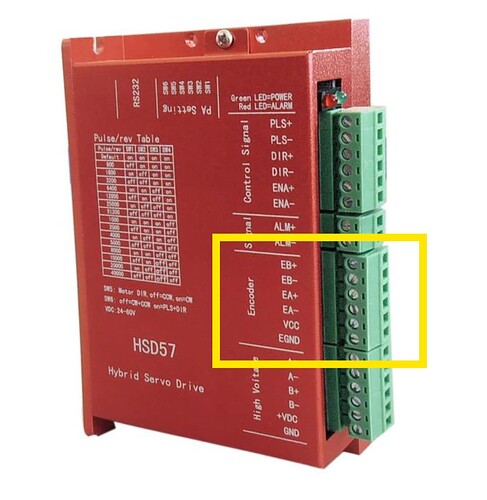

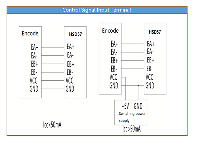

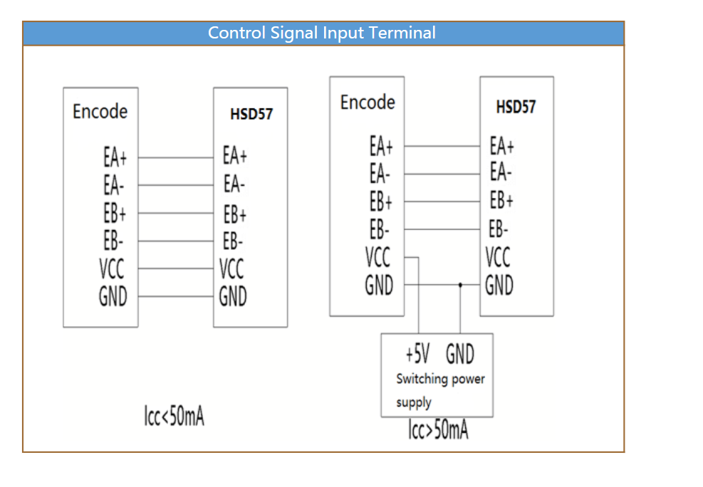

Thanks for replying. I try this one rn but my driver gave me red light seven times for one period. I looked at the Leadshine's datasheet and it says that means Position Following Error Protection. This is an closed loop driver. Do I have to cabled my Encoder cable to driver or RS233-TTL to my computer? I am so confused
Yes encoder cable from the motor should be connected to the driver, as shown
Thanks for replying. It seems like my connection diagram fit in with Common Anode one. But How do I change the my code for Common Anode?
You just replace every LOW with HIGH and HIGH with LOW on your code.

Thanks for replying again. My driver has 6 input for encoder data's. However I can't get How should I supply 5v for encoder? Cause it has red an white cables for VCC and GND.
I did it but still same. If I don't misunderstood that the Closed Loop Driver doesn't work without encoder cable's. I don't understand the relation between ardunio which my code doesn't have any encoder value. How this driver read my encoder without any settings

As @bobcousins has pointed out, the Vcc and gnd terminals, check with DMM.
yes it is. If I just plug this in, will it be active immediately or do I need to make an additional setting? Also, does it feed 5v and ground from within itself?

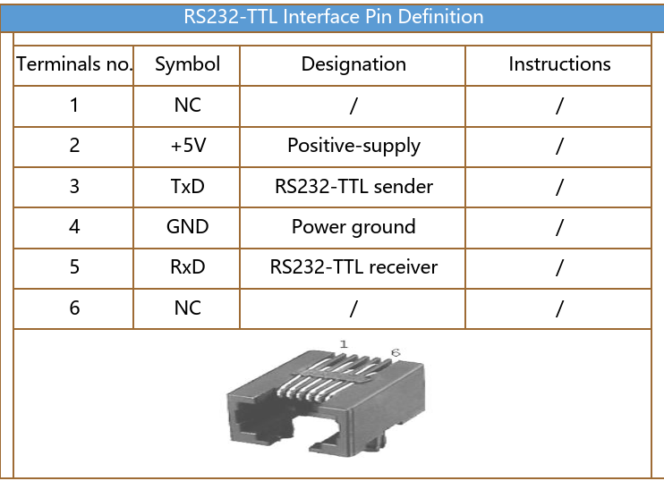

Thanks for everyone comments, I just plug the encoder and motors run :joy:. You guys saved my job, really apprieciete it. Howver I have new problem. How will I see the encoder values from Ardunio, in my application, I need to send encoder data to another computer. All I see is the picture I sent. I have TTL cable, Should I cut the cable on one side and plug it into the Arduino on the other side?
How can I see the encoder value in Ardunio
I don't know that you can do that easily. I suppose that you could make a Y cable and interpret the encoded data on the Arduino.
I understand that the RS232-TTL can be used to configure the drive and perform some movements. There may be some software available to do that, and there may also be a specification somewhere of the commands you can send. I haven't seen a specification for either of those. You may be able to get them from your supplier or perhaps direct from the manufacturer.
