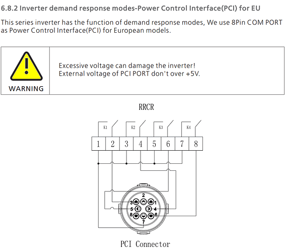

My goal is to digitally emulate the output of the TOP_90-S10_SP4 CT clamp so that I can arbitrarily control my 2x Growatt Inverter's power output to prevent exporting too much power back to my local grid, whilst allowing them to heat my water tank using a solar diverter prior to limiting the export function.

It looks like you are intending to do this. You also have the option of emulating the Eastron SDM230-Modbus smart meter https://www.metermarket.co.uk/assets/product-downloads/Eastron-SDM230-Series-Datasheet.pdf instead of a current transformer.

Hi @DrDiettrich that was the first thing that I attempted before taking the CT-clamp emulation approach. I can connect to the 'export control' modbus and dump the registers but the register map is unknown so I have no idea what data to push to where in order to activate dynamic export control.
These inverters have two modbus interfaces, each has a different register set. The main modbus interface is well understood and I already have a working interface for this outputting all of the real-time inverter stats.
Page 27 of the manual references the RRCR (Radio Ripple Control Receiver) and that's another option that I'm exploring. I looks as though it's a just a case of shorting various pins in order to activate 0,30,60 or 100% of export control.

I think you're right, putting my efforts into emulating the Eastron or the RRCR interface is going to be easier than emulating a CT clamp.

This is somewhat off-topic (I could start a new topic?), on page 27 of the manual it references the Power Reduction Interface Connection.
Whilst not very granular, it looks like a simple interface to emulate as it only requires the shorting of different pins to control the Inverters power output as a percentage (of current generated power?)
Would I be right in thinking that I could emulate this with 4 relays attached to an Arduino?

I think that i now have it figured out using the PCI port that i described above.

I think the PCI interface looks promising, I'm not at home right now so I can't try it.
