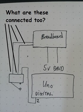

Endstop image attached

In particular, how you have wired your limit switches.
does the end stop include a builtin pull-up resistor ?

Endstops are here, but I am not sure if they have a pullup resistor (I'm a beginner at this) https://www.aliexpress.com/item/33023678899.html?

Sure - https://www.aliexpress.com/item/33023678899.html?

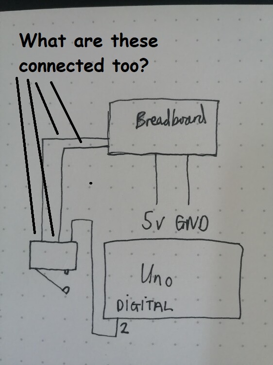

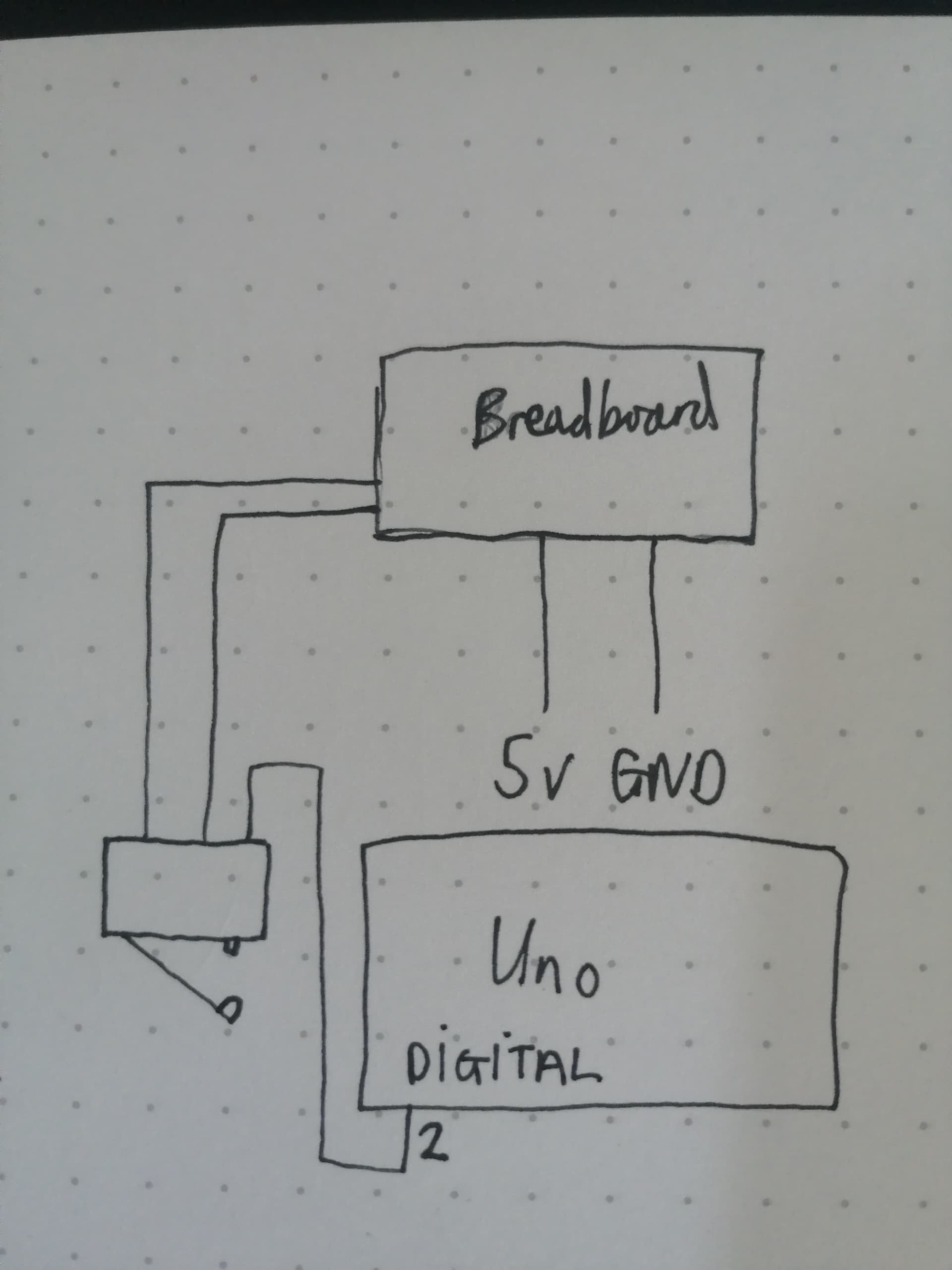

I just have the endstops powered through a breadboard and plugged directly into the digital ports on the uno
You are using all 3 contacts of the the microswitch. Does the UNO pin 2 ever go to float condition during switch transition? That may cause an undetermined condition (not high or low guaranteed) for the input.

Can you place a DMM in DC volts and measure with respect to gnd the voltage on the digital input pins that are connected to the limit switches when you activate them.
