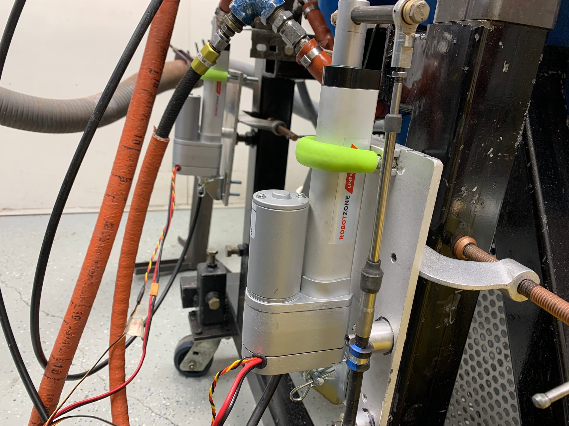

I am working on a live throttle control using a potentiometer for servo position control. I can get the servo to work well with the potentiometer except I need to be able to set the min and max throw of the servo as to not hyperextend and break the carburetor on full throttle or idle. The Arduino "knob" script works fine but I need to be able from a push button or knob set these min and max limits prior to testing the engine. My Tinker CAD worked fine but it's not working in reality. I used a min potentiometer and a max potentiometer but not great. Buttons would be perfect to set the min and max also. I'd appreciate any help the community can give. the simpler the code the better it works. If KNOB can be modified to accept min and max from I'd take it.
Basic function:
- Turn on the power supply and arduino.
- Swing the potentiometer/servo to a good max position and set value.
- Swing the potentiometer/servo to a good min position and set value.
- Use while running the engine in the range.
- Next engine the settings will change so need to program again (maybe requiring a reset button)?
Again... "knob" works but needs programable and (re)programable min and max.
TinkerCad (two shown but code the same on each board). Login | Tinkercad
