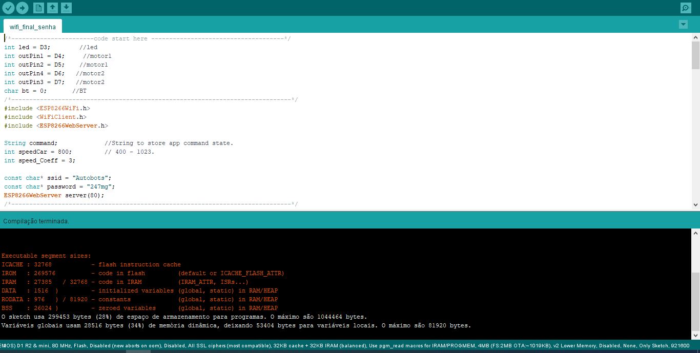

I have a cart project that works with cell phone and via wifi network.
I have the problem that as soon as I send the code to the board, the wheel motors start and do not stop.
The card I'm using is WeMos D1 R1 Wifi ESP8266.
The compilation also does not point out errors.
Code:

Could your serial also contain a CR and possibly a LF chareacter?
The fact that you do not get any errors is a good thing but it does NOT tell your code will work, only that the compiler can put into code. If you upload it it will run and do what the code instructs it to do. This is good but if it is not what you want then back to the coding.
That should be easy to diagnose and fix by yourself. Work your way through the code and circuitry, answering the following questions in order.
  • Starting from the motor electronics: what signals are required to start the motor?
  • How and why does your program produce those signals upon startup?
  • Why does your program not produce signals to stop or otherwise control the motor as desired?
