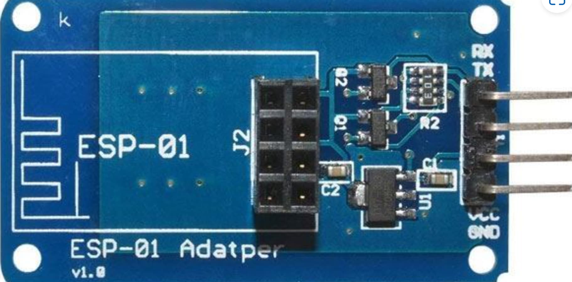

You can see it on image. There is ESP-01 adapter which has 3,3V regulator.

Not directly. It is connected through adapter. It is standard adapter which is selling to make ESP-01 5V compatibility.
I can't help if I don't know anything about "standard adapter" and the wiring between Esp and Arduino.
This adapter.

Those adapters are fairly decent, level shifters and on board regulator. Not perfect, but not a big issue. A slightly bigger capacitor on the 3.3v rail would be good.
Fragile yes, i found that too, but once you have it down it should be reliable enough. a dedicated 3.3v regulator helps a lot
