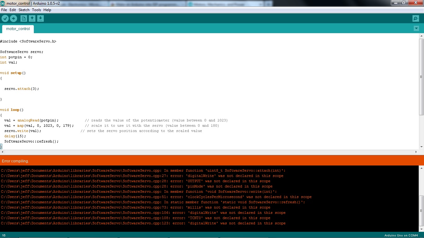

error compilling

Instead of wasting 235.3 Kb of disk on a screenshot of the error, how about copying and pasting it here?

What's SoftwareServo? Where did you get it? How did you install it? More detail would be good.
I think you need
#include <Arduino.h>
thanks for the reply it seems that i can't copy the error message i don't know why i right click but the little box with the options does not show up. but what im trying to do is control a esc (electronic speed control) with a attiny45 but i was going to just run it with a nano but i got an error message i can't use servo because i plan on using the attiny once ever thing is working

but like i said im just trying to run it on the nano right now well i used verify i never tried to upload it the way i installed it was by using the sketch>import library>add library and i can see it at the bottom sketch>import library now so i guess it's installed right

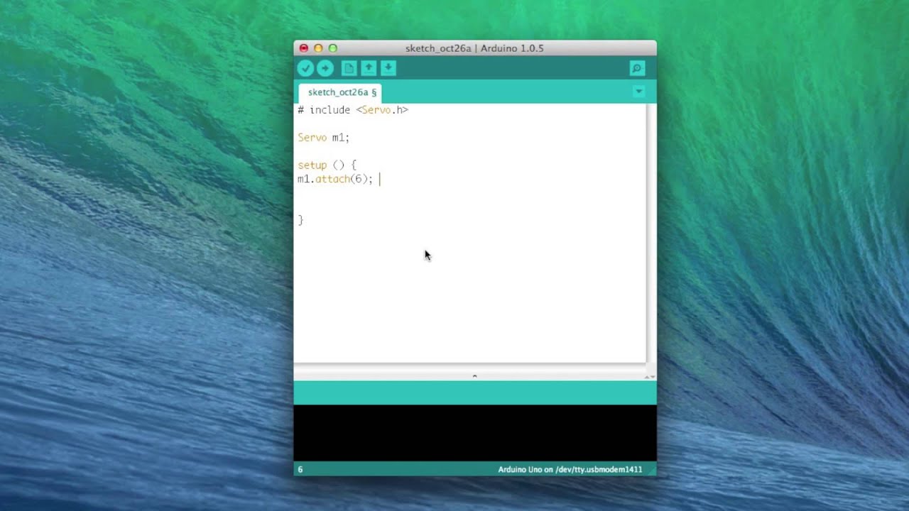

and here is a link of a video to how to run an esc with software servo

i tried adding #include <Arduino.h> but it does the same thing
