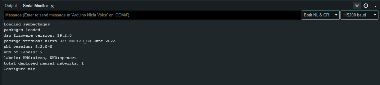

I would like to elaborate on error in deploying Alexa demo on Nicla Voice. More specifically on a problem I have with NDP library's "Record and Stream" example I describe in another forum audio-analysis-with-machine-learning-and-the-nicla-voice. I would be glad to know if anyone succeeded in using the Record and Stream example in Arduino IDE.
I'm trying to make the Alexa_demo sketch work.
I did the following steps:
Uploaded sketch Syntiant_upload_fw_ymodem
Formatted flash "F" via serial port monitor
Confirmed with "L" -> empty file list displayed
Uploaded mcu_fw_120_v91.synpkg
Uploaded dsp_firmware_v91.synpkg
Uploaded alexa_334_NDP120_B0_v11_v91.synpkg
All of them "sent successful"
Confirmed that the files are on the Flash memory -> Serial Monitor "L"
Uploaded sketch "Alexa_demo", and by checking the Serial monitor the packages are loaded.
When I speak to the microphone (saying "Alexa" or other words) nothing flashes (onMatch, onError, OnEvent).
I could see that if I press "f" / "o" interrupts are disabled/ enabled as described in the sketch.
Any hints of what I'm doing wrong?
Thank you so much for the help.
Best
Paolo
