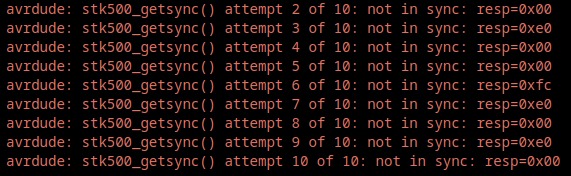

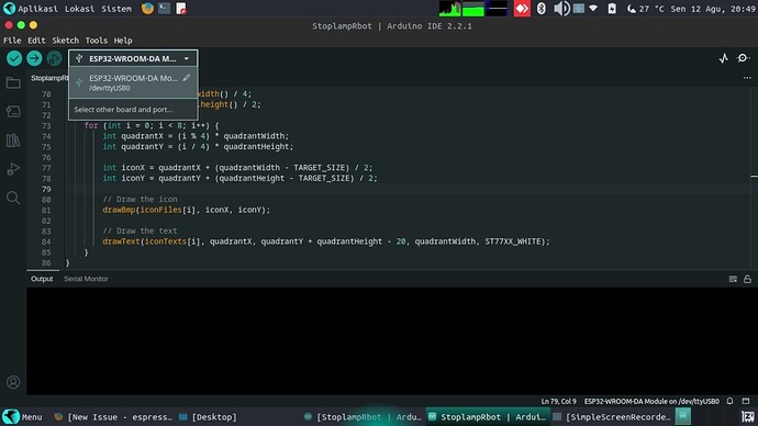

Here the two software cannot be uploaded, in the case of Arduino 1.18.9 the port does not appear and in the case of Arduino 2.2.1 an error appears as shown in the image below
461480701_3944862129075651_5624259604683076673_n

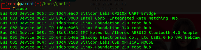

CP210X
here i can only upload on arduino ide 2.2.1

I don't know, before I was fine using all my usb serials. Today I tried again and it turned out that on Arduino 1.18.9 no port was found and then the prolic driver experienced a problem of not being able to upload on all versions of Arduino Ide and Silicon Lab only worked on Arduino Ide 2.2.1

Initially Arduino Ide 2.2.1 sent a notification about the Arduino board update, after I updated suddenly on Arduino 1.18.9 the port didn't appear and finally there was another problem until now I can't upload my Arduino program using USB TTL, even the default USB TTL esp32 also having problems with ports not showing up on 1.18.9 but esp32 still working fine on arduino 2.2.1

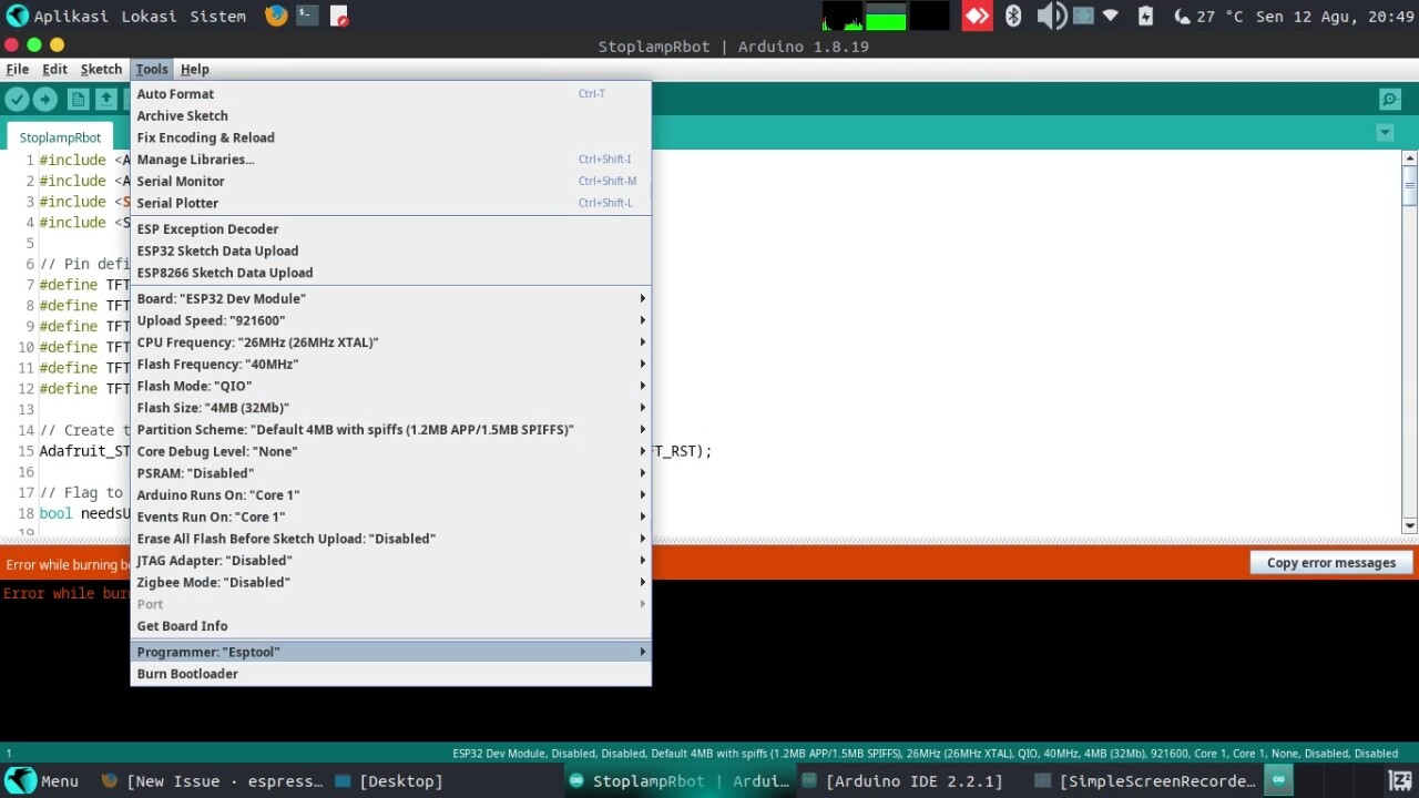

Error when I plug into Arduino 1.18.19
Exception in thread "cc.arduino.packages.discoverers.serial.SerialDiscovery" java.lang.IndexOutOfBoundsException: Index: 0, Size: 0
	at java.util.LinkedList.checkElementIndex(LinkedList.java:555)
	at java.util.LinkedList.get(LinkedList.java:476)
	at processing.app.Platform.resolveDeviceByVendorIdProductId(Platform.java:188)
	at cc.arduino.packages.discoverers.serial.SerialDiscovery.forceRefresh(SerialDiscovery.java:166)
	at cc.arduino.packages.discoverers.serial.SerialDiscovery$1.run(SerialDiscovery.java:96)
	at java.util.TimerThread.mainLoop(Timer.java:555)
	at java.util.TimerThread.run(Timer.java:505)
Hi @bimosora. Is there a specific reason you are using Arduino IDE 1.8.19?
I ask because it looks like maybe you have encountered a bug in Arduino IDE 1.8.19. It sounds like maybe you are also having some problems with Arduino IDE 2.x, but probably less serious problems. If you don't need to use Arduino IDE 1.8.19, I think it would be more productive for us to focus our efforts on solving any problems you might be experiencing with Arduino IDE 2.x and avoid having to try to find a solution for this tricky Arduino IDE 1.8.19 bug.

Thanks for the enlightenment. I found the solution to the unreadable port problem here Arduino IDE 1.8.19 in Tools menu Port grayed out
Nice find! The problematic configuration in the STM32 boards platform that caused this has already been adjusted:
That change was made after the time of the last release of the platform, but it will be in the next release of the platform and you should be able to use the STM32 platform with Arduino IDE 1.8.19 without having it break your ports menu after that version comes out.

I tried uploading with usb TTL on Arduino Nano and Arduino Pro Mini boards. Same problem on all. Previously usb TTL was normal on any Arduino

I use usb ttl pl2303
