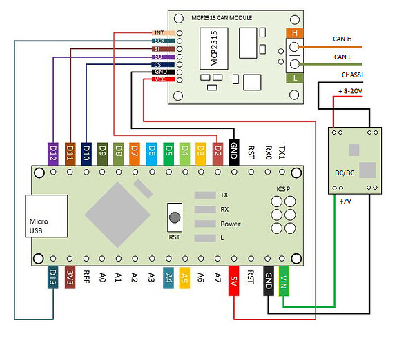

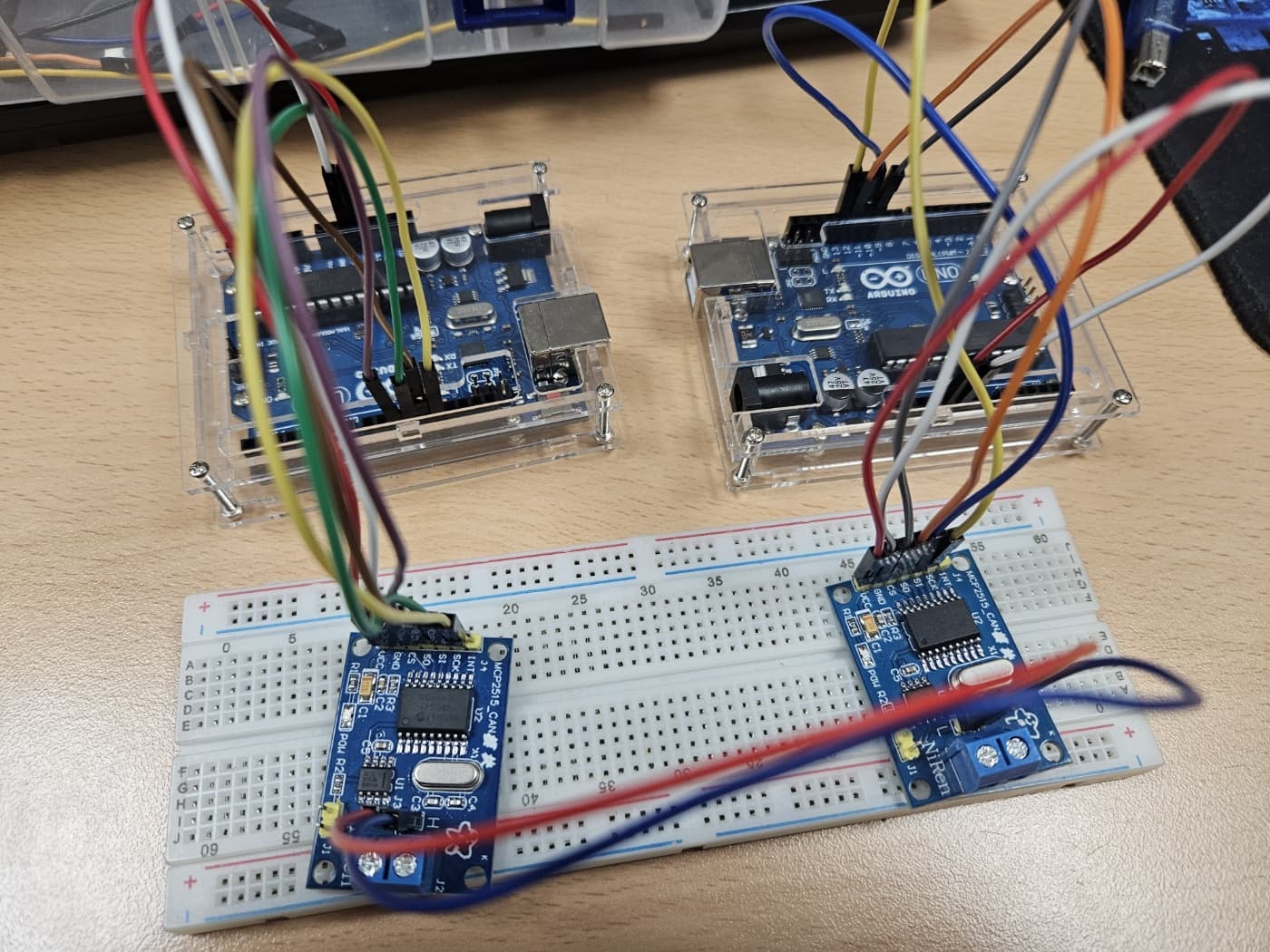

Hello guys,
I'm here having some problems with mcp2515 module with arduino uno.
I'm doing project which is control T motor with arduino using can bus communication.

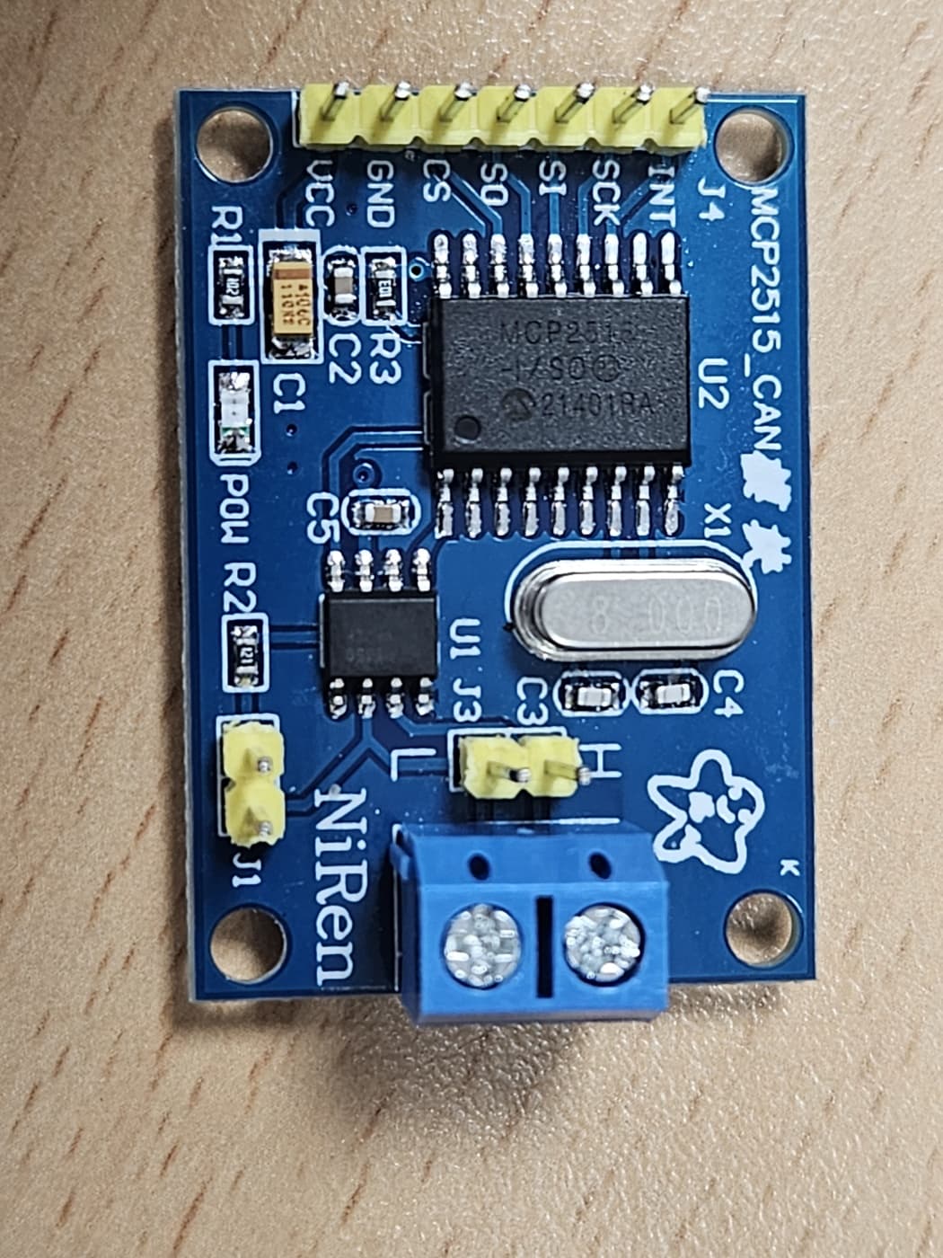

For hardware setup, I used arduino uno and mcp2515 moduel with 8MHz version.
Before connecting motor, I tried to connect 2 arduino uno with example of GitHub - coryjfowler/MCP_CAN_lib: MCP_CAN Library (can_send & can_receive).
When I run the example code, the can_send example output only "Error sending message..." and can't find the solutions......
Baudrate : 115200 | Using CAN_500KBPS |
