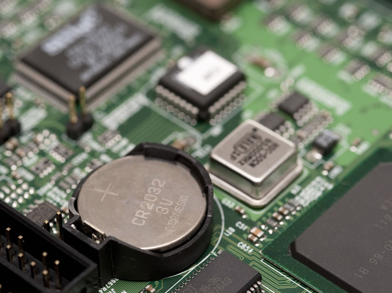

I’ve had to change the RTC battery on the 95 computers twice :mantelpiece_clock:
OMG 26 YEARS
