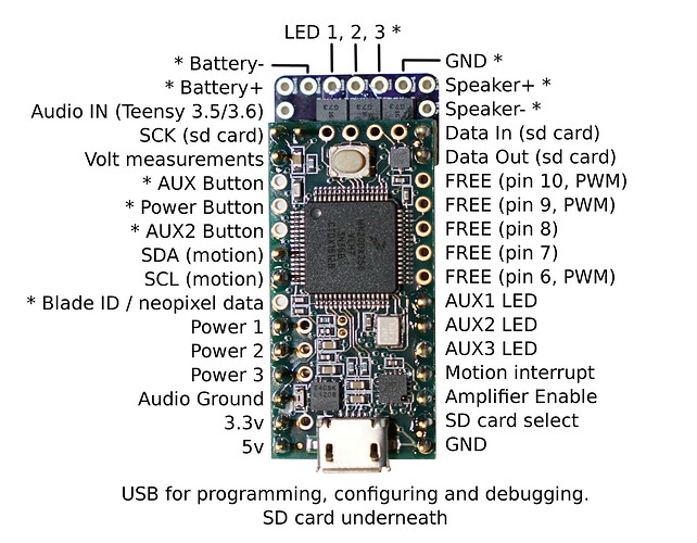

Yeah I only do some light tinkering with this and I've never encountered this error until trying to do everything on this brand new PC so I'm not really sure what I messed up along the way or if I'm simply missing a file directory or something. If you need a picture of the board I have some here.
