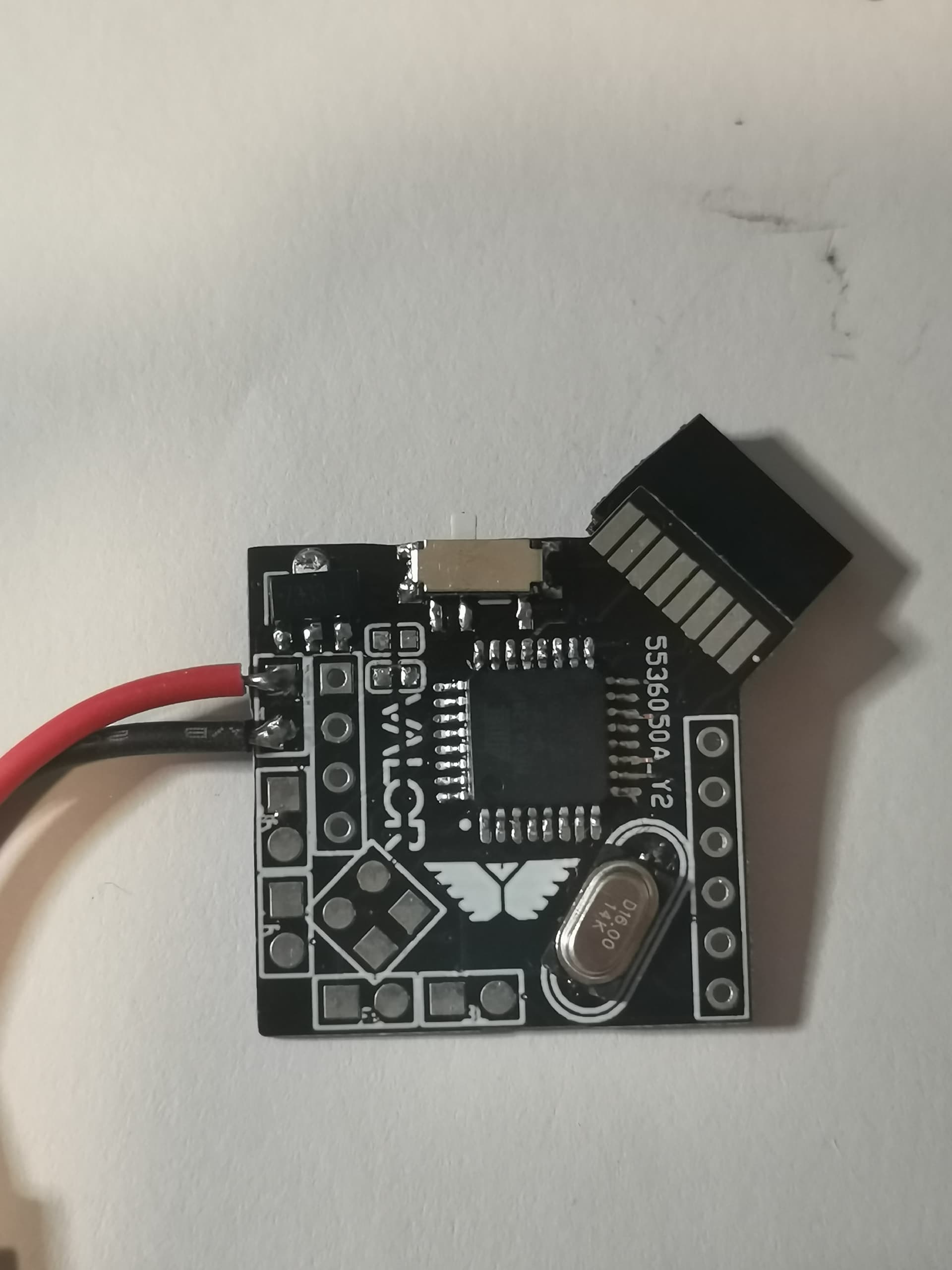

I've made a custom pcb and I was trying to burn Bootloader to an ATmega328P-AU SMD chip, but got several variants of error. I've tried to do some research but had no luck, can anyone help me with the issue please?
there are several types of error stating that the device signature to be:
- 0x000000 (might be due to the reason that the crystal was not working according to the research, but also get the same Error when MOSI & MISO was pluged in reverse when I tried it
- 0xffffff (this is the most Error I've got, which has occured multiple times and I couldn't figure what it ment)
- 0x[random] (sometimes it spits out random signature code, still no clue why)
I've tried and slodered together two identical boards, each with crystal & capacitors, but still got the same issue. maybe it's something to do with the board designe cuz I really don't have experience doing so, can somebody please help?
and also, here's my board Schematic and stuff as screenshots
and here's the output of buring bootloader with Arduino as ISP:

pls help
