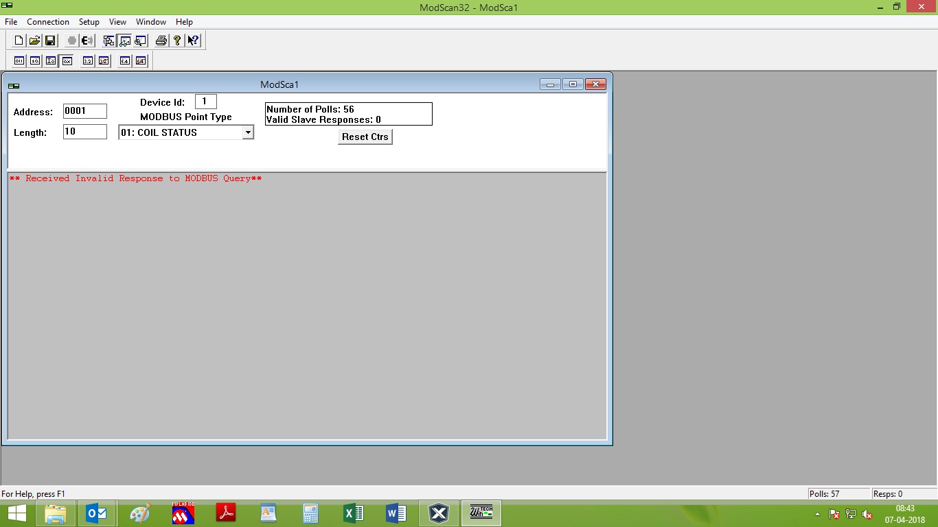

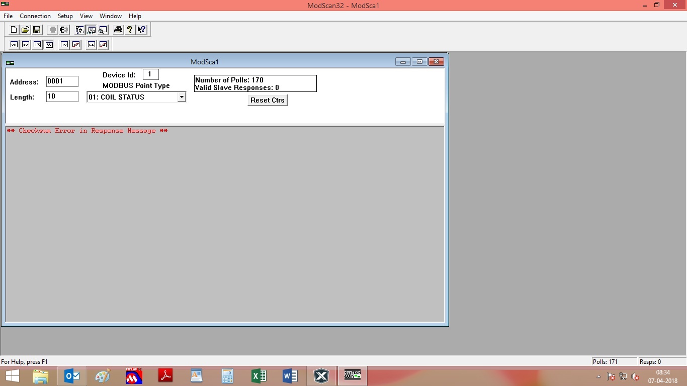

Dear all ,
I am implimenting modbus RTU in c on atmega328. I am sharing part of code. Below code work fine for function 3. But i get checksome error for response for function code1.
I have make ensure CRC function is working well with below code. But sending modbus response i get an error.
I have attached Screen shot of request/response from slave device.

I am suspecting on below parts ,
- moving the data into serial buf
2)calculating length of coil.
crc_data[0]=Device_ID ;
crc_data[1]=rxbuf[1];
crc_data[2]=length;
j=3;
for(i=address;i<((address+length));i++)
crc_data[j++]=ser_data[i+3];
// ChecksumCal(length);
crc1 =crc_fn(&crc_data[0],(length+3)); //crc function for response protocol from the device
Serial_1_Send_byte(ser_data[0]);
Serial_1_Send_byte(rxbuf[1]);
Serial_1_Send_byte(ser_data[2]);
Serial_1_Send_byte(ser_data[i+3]);
Serial_1_Send_byte((unsigned char)crc1);
Serial_1_Send_byte((unsigned char)(crc1>>8));
function code1: http://dghcorp.com/modbus/modbusrtu01.asp
Data HI 7C - Data Coils (17-10) Status
Data LO 03 - Data Coils (19-18) Status
function code 3:http://dghcorp.com/modbus/modbusrtu03.asp
Data HI 7C - Data Register HI Byte
Data LO 93 - Data Register LO Byte
Can someone suggest me what changes can be done to make work on function 1
