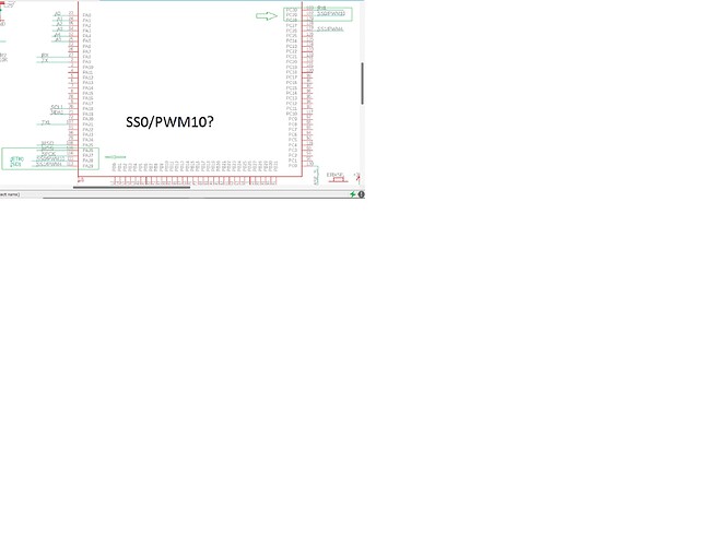

I noticed that the DUE .sch has 2 pins marked as SS0/PWM10. Please see photo. Why is this? What are they used for?
