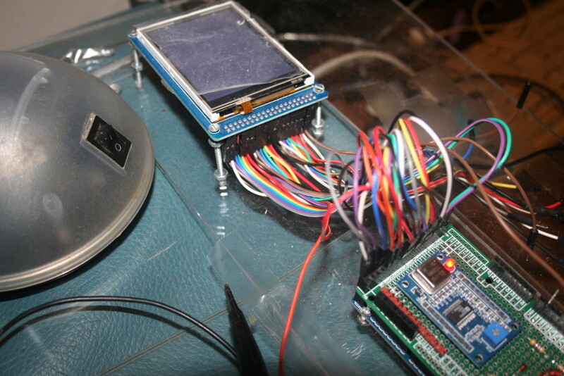

Than you MAY get a different idea AFTER you look at this mess of 20x2 header "breakouts" connected back to back. The rainbow of colors of the wires makes me dizzy.
I think "breakout" concept should be primarily for experimenting , proving the concept, hence making them sub-miniature and stack-able may not be the best way to go.
After all, cost of dedicated , not universal, PCB does not add that much to the final product.
Point taken but the purpose is mainly to be able to more directly work with the chip. You can't really use the DUE to breadboard a design. The UNO is fairly simple to plug in the chip and make your connections. Stackable is not in my vision here. The header layout was taken from the chip.
It's one thing to develop, to a point, on the DUE for proof of overall concept, but the 'embedded' concept is totally different than the UNO because of the complexity of the chip. I wouldn't expect something like this to be commercially viable or even popular among most hobbyists. One is all I'd need but getting them from a place like Batch PCB comes in multiples of three so just get a few people and make an order, share the cost type thing if interested.
Actually trying to run traces I realize I made an 'error in judgment' and it would have to be a 4 layer board. Still, price wouldn't be too bad on something like that even if I did all three for myself.
I appreciate the input though. I've been thinking about this for a couple of weeks but had no immediate plans to do it. But the idea is out there and we can gauge interest I guess.
There was a discussion about year ago or more , a fellow was "developing" in the forgotten "stuff on substrate" style. Connections on the outside of the sub boards. Did not heard much from him lately.
But from brief experience connecting Due to TFT LCD - it would save lots of headaches if the I/O were laid out as 8 bits ports. At least on the processor side.
But than it would be no fun trying to shuffle bits around to match the hardware.
I think if you use current Due hardware ( power supply etc ) and build the I/O in headers style as you envision it would fly.
Than of course some folks would want access to ALL USB ports and you are back to "stacking".
