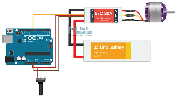

Hi there! I was trying some pid code on 2 bldc motors. The setup is something of this sort:
This is my circuit:
Except that:
  • I have used the 3 GND pins of the Arduino Uno without combining them
  • I have a 30A esc
  • I did not cross-connect one of the ESC-motor pairs

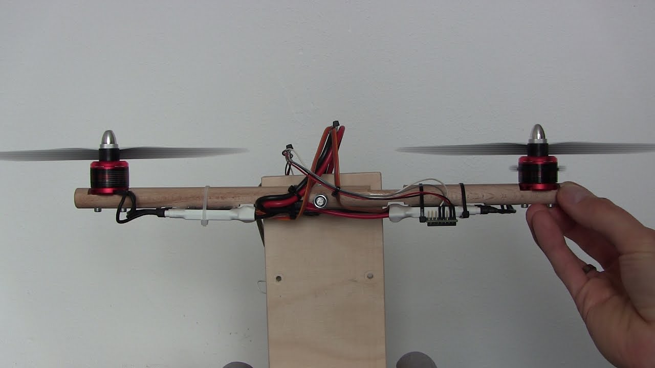

Everything worked fine as I changed my pid values. Suddenly my bldc motors stopped turning and began beeping. When pushing the reset button on the Arduino Uno the motors started spinning for half a second and stopped, and then the beeping sound started again (see video). To check if the problem was in the code, the bldc or the ESC, I uploaded the following ESC calibration code:

I removed the propeller from one of the bldc's and started the calibration. I succeeded in varying the bldc speed from 1000 to 2000 with steps of 100. With each step I could hear that the motor spinned faster (except when going from 1900 to 2000; there was no difference in motor noise). Then I put the propeller on the bldc and tried the same; I could only go to 1300 (30% of the max speed). When reaching 1400 (40%), the motor stopped spinning. I did the calibration test on the other motor (first without propeller and then with it) and got exactly the same results.
I then bought 2 new same motor-esc pairs and got the same problem.
I tried with an Arduino Nano and the problem persisted.
What could be the problem?

There are 3 GND wires in the circuit:
  • GND wire of ESC1
  • GND wire of ESC2
  • GND wire of MPU6050
I have connected each one of them to a GND pin on the Arduino Uno, which has 3 GND pins :slight_smile:
I have now tried this circuit:
(Except that I am using 2 motor-ESC pairs on pin 3 and 5)

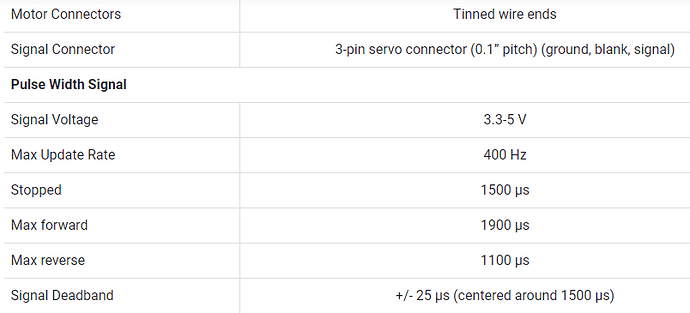

@mrfimskiy I'm out of ideas. Whenever I get into a situation like this I will go back to basics. Being comfortable with BLDC motors I would concentrate on the ESC. I looked at you link and couldn't find the control details.
So I looked for other ESC controllers and found some have a different transfer function. Look at the attached and consider if your ESC input signal is similar.

In the video I see a 10Amp lab supply that collapses (voltage readout) when the motors spin up.
A collapsing supply is the same (for the ESC) as turning the supply off/on.
Note that the motors draw at least 10Amp (maybe 20A) each on startup.
And maybe 10Amp each when spinning with the added load of a propeller.
So that 10Amp supply is totally inadequate.
Volt-drop in the supply leads could make things worse.
You could try a 3S LiPo battery that can handle the current near the motors,
With the supply set to 12.0volt, and also connected.
Both these supplies might be able to power the setup.
Don't leave the supply permanently connected to the battery though (safety).
