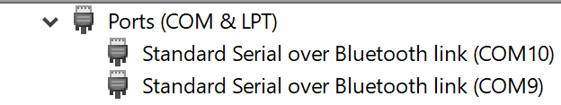

I have checked the Ports and it doesn't show up as any COM.

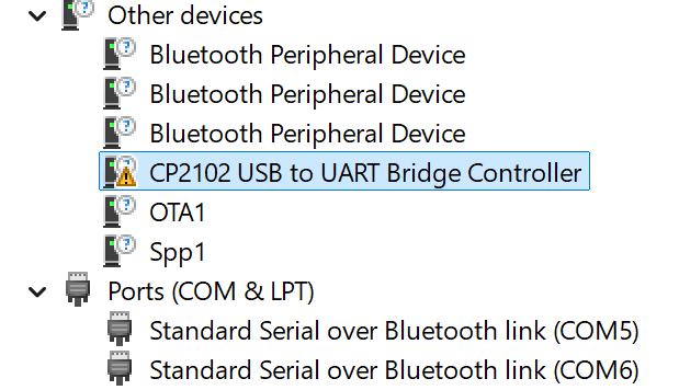

It shows up in Other Devices with an error. Has this ever happened to you? I don't exactly know what to do to fix this issue.
I guess you don't have the driver installed for CP2102, but that's only a guess.
