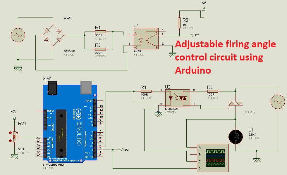

here i can dim my built in led in pin 2 but i know it's not works with triac for ac dimmer circuit
PWM is not used for AC circuit control but is controlled by phase angular control. Only work with an AC main if you really understand what you are doing because it is potentially dangerous and / or deadly.
i already complete same thing on ir remote for ac dimmer in arduino nano but thanks buddy
here i try this one but my ac lamp is blinking at 100 and at 0 it's looks like turned of

Looks like a timing issue. How did you work out the range of the dimming variable? Have you put an oscilloscope on the AC line and the dimming pin to see how your triac pulses align with the AC cycle? That should pretty much tell the full story.
Quoted in bold for emphasis. Very true, this.
Also, I'd always think twice before TRIAC dimming a load. It creates nasty junk on your AC lines/grid. Since dimming is used in many cases for lighting purposes and we tend to opt for LED lighting these days, PWM-ing a DC power source makes much more sense at this day and age.

Now you delay holds up the processor, and has a maximum of 7.2ms
It is anyway a bad idea to use delay in an ISR, that is why you use a timer ISR to trigger a counter to determine when to flick the switch.
If you want to make something that you can just 'drop-in' on an existing switch, triac dimming is a better option, but you have to really know what you are doing. Some AC-lamps are not really suitable for triac dimming, and filament LEDS have capacitors in them that can influence the holding current to the triac, causing it to turn of pre-maturely.
well i don't have oscilloscope and also i found a code from you tube which i modify a little for web server

The diagram surely has to be clearer that the AC source is not the same in both cases. The 4N25 opto coupler would not last very long with rectified mains voltage passing through it's led with only a 165 ohm series resistor:
This looks like a circuit for a 5 volt arduino to control a mains circuit using an infra red remote control. Can you post the code which corresponds to that circuit.
If you are to use that as the basis for a Blynk controlled system, you'll have to make a number of changes and then build it in stages which you can test separately.
Probably, it would be best to get the circuit to perform with the ESP32 exactly as it does with the 5 volt arduino, adapting it as necessary.
Stage 2 would then be to integrate Blynk to replace the remote control.
yes it's for ir remote control circuit 5v for nano as you describe
here is code

Normally speaking for 230 AC i would use in series one on either side of the 4n25 2x 33K 1W (Or 2x in series 3x 100K in parallel 1/4W) Putting a coil to convert the voltage would defy the purpose of trying to recognize the zero-crossing, due to the lag of the coil.
This does look more correct. You can probably reduce the freqStep for higher resolution
Th this point I'd walk away, to be honest. Its stumbling blindly in the dark without one, especially for this kind of circuit.
I'd consider getting a decent USB scope; they're not insanely expensive anymore.
I don't know. The code sample with ticker was only to show you how to adapt your Uno/Nano IR (infra red) controlled dimmer sketch to use ticker as part of a conversion to ESP32.
You have not shown a schematic which has been adapted to the ESP32. The schematic which you have shown for the IR based dimmer needs some work before it could be used with an ESP32.
