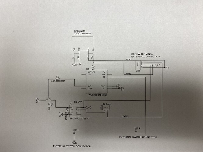

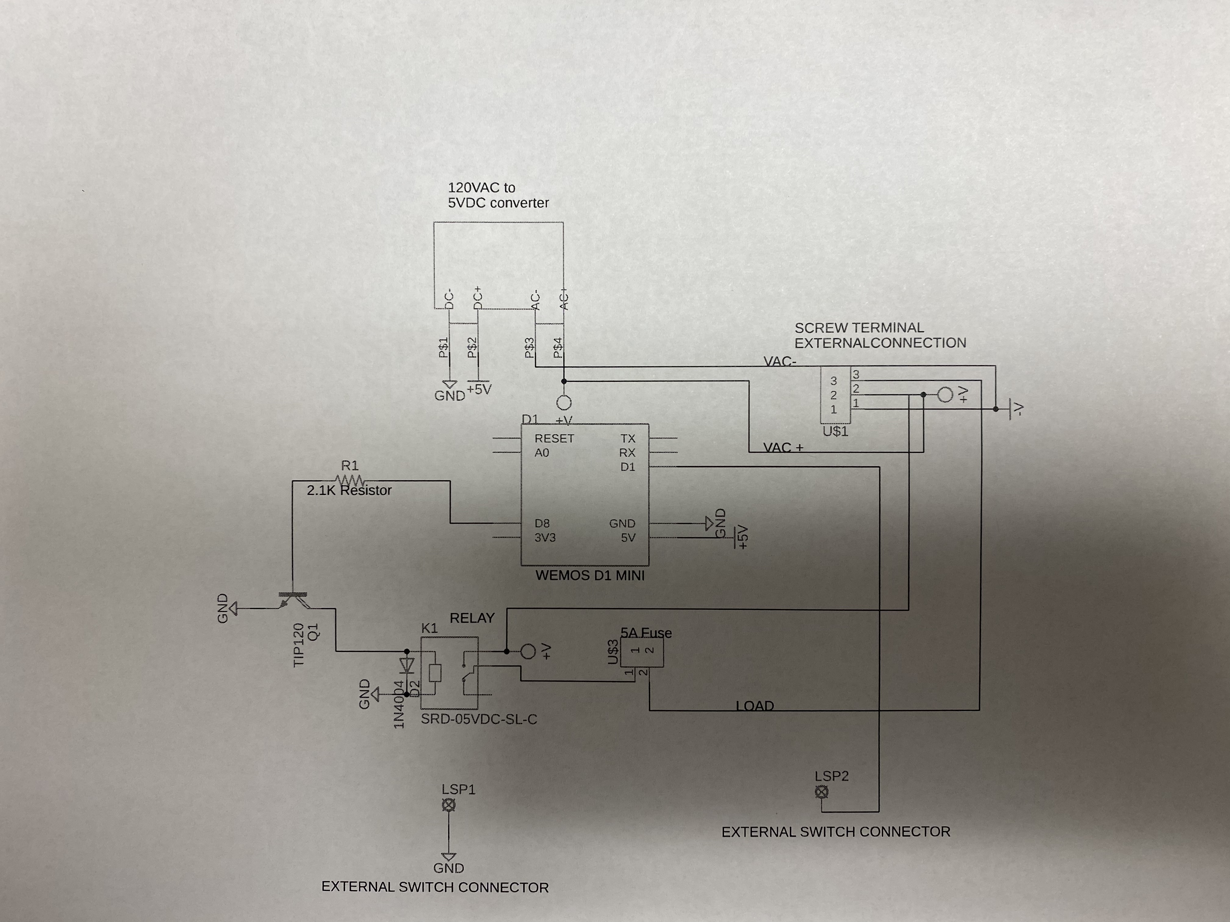

Ok, I have a little closer diagram of what I am trying to do. I am looking for advice/criticism. @LarryD I am going to be making a pcb again and hoping you will correct all my mistakes as you did in my previous pcb!
Again this is what I am doing: I am using a wemos d1 mini, a 120VAC to 5VDC supply board, I am planning to have the wemos board send a digital signal to a transistor (TIP120 at this point but open to advice), The TIP120 (or whichever transistor/mosfet/optocoupler is best) will activate a songle srd-03vdc-sl-c 10a relay (could use a srd-05vdc-sl-c 10a if needed) . The relay will control a 120VAC load that I anticipate being less than 5A. The coil resistance on the 3v relay is 20-25 ohms at 120-150mA and the 5v relay the coil resistance is 70-80 ohms with 71-89mA. I have read many threads on doing this calculations (even one that I started and had great answers), but I can't figure out the best way to determine which transistor/resistor combination to use. I know the tip120 will work because I have tried it and I have them readily available, this is why I chose it. In my schematic and the one that I tried, I used a 2.1k resistor/tip120 combination.
I also have included a 1N4004 diode across the coil of the relay. I know that I need this flyback diode, but not exactly sure how to choose the right one.
I have a fuse inline of the load set at 5A. I would like to be very conservative with my fuse. I do have it set in the AC- side which I don't know why this would not work.
Here is my schematic at this point:
Thanks!
Suggest you draw your schematic in a more standard way, lots of example on the WEB.
A TIP120 is over kill.

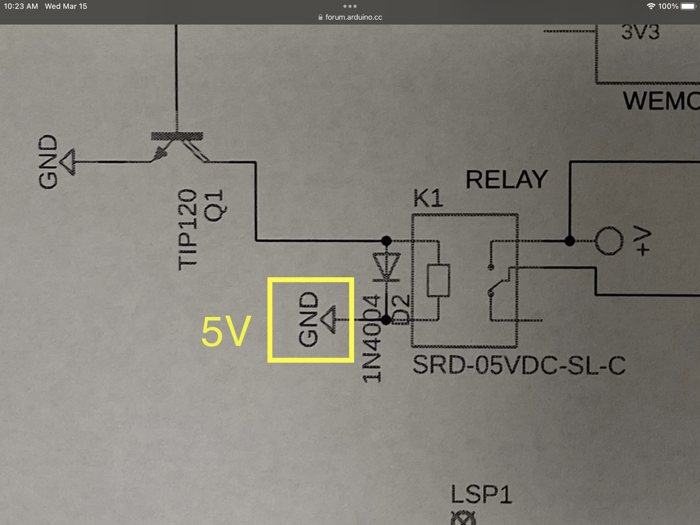

This is the schematic that is coming from fusion/eagle. Are you saying that should be 5v instead of GND?
Thanks!
Yes
Ah Ok, I missed the GND/5v mix up. I will fix that. Is it bad to use the tip120s since they are overkill? What will it hurt? What is better?

The TIP120 has a saturation voltage which is quite high. > 1.2V
Essentially it steals this from the relay.
Better to select regular NPN BJT where the saturation is around ~.3V
Suggest you place the fuse in the V+ line.
Just an aside:
Schematics are generally laid out to "read" left to right signal flow. (inputs left, outputs right). Then individual components arrainged by voltage. Highest voltage at the top of page, lowest at bottom. This is the "natural" layout. Try to arrainge accordingly. The "ground on both sides" error would be much more noticable. As would voltage mixing errors (a high voltage lead wandering around in low voltage areas.) The electrical separation becomes physical separation and drawing visual separation -- all must be maintained, especially when mains voltages/currents are expected

Fuse so an external overload doesn't fry your traces.
Often the readily available 2N2222 transistor is adequate.
The pick current of those relays is quite low.
What is the resistance of the relay coil ?
We usually add a fuse as close to the source as possibly so the complete external wiring is protected.
This would mean, place the fuse where the V+ comes on to the PCB.
The circuit flow is usually left to right, top to bottom, plus voltages at the top of the schematic.
