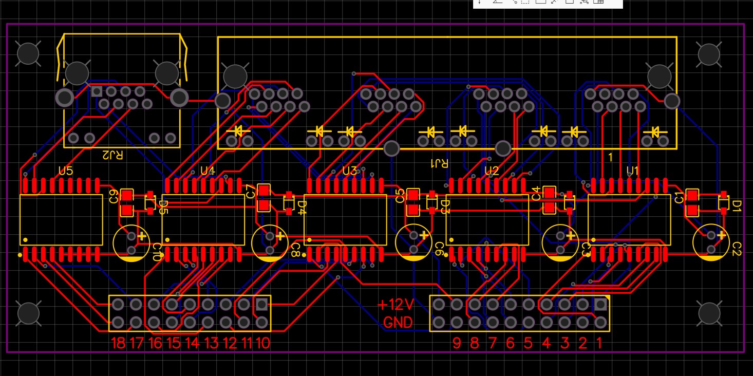

Suspected EMI issues. AC relays
I am looking to control 18 latching relays from an Arduino Mega. The relays will control a series of 240V AC lights.
I have tried to do my own research, due diligence and follow best practices.
The problem: when I am turning the lights on and off, the board will appear to be 'hung', eventually the watchdog timer will reboot the board and it comes back on line and I can control it again. This only happens when there is AC load through the relays.
I have designed two PCBs, one a board with ULN2803s on, and a second board with the relays on.
I finally got round to wiring it up this weekend, and the code works well, the relays all work as intended UNTIL I turn the AC load on.
The relays are 12V coils, I power the Arduino with a 12v barrel jack, and take the 12V to power the coils from the VIN pin.
I use the flyback diode on the ULN2803 to minimise kickback voltages from the relay coils. I had hoped this was enough. And it seems to be. The code runs flawlessly when the relays are controlled but there is no 240V AC going through them. I can turn the relays on and off to my hearts content, and the board doesn't 'hang'.
As soon as I have the AC power going through the load, a couple of flicks of the relays will cause the hang up.
This leads me to suspect that I am getting EMI rather than bad code or issues with the kickback from the relay coils.

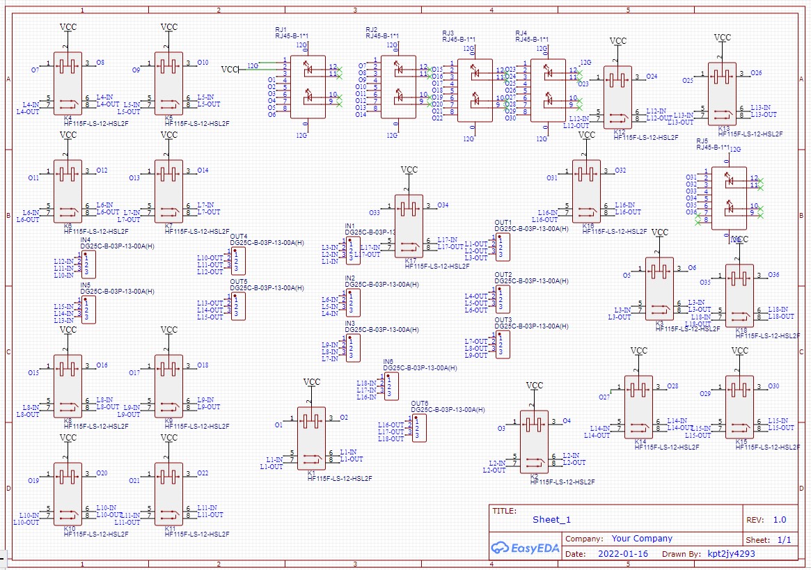

I will also attach pictures of the PCB boards and both their schematics.
The Arduino is mounted and connected via jumper wires to the ULN2803 board.
The ULN2803 board is connect via 5 ethernet cables to the relay board.
The relay board schematic looks a bit overwhelming, but essentially each latching relay has a COM and two 12V inputs on the coil side. There is nothing on the relay board except for the relays, 5 ethernet ports and screw terminals for the AC loads.
The relay board has 18 relays, which means there are 36 outputs from the Arduino.
This leads to 5 ULN2803s, each 2803 has a 100nf ceramic capacitor, a 10uf aluminium electrolytic capacitor and a Zener diode. All of these are positioned next to the power pins of 2803s. This was done based on advice I read online to help protect the 2803s form the kickback.
I also have utilised the built in flywheel diode on pin 10 of the 2803s.
The wires between the Arduino are neat and well organised. The 5 ethernet cables going to the relay board are straight and neat.
The crux of the question how do I go about reducing the (suspected) EMI I am getting when the AC power is on?
I see several things. The com pin (10) from the ULN goes to the + of the capacitor but no where else. It is a very fast rising signal and the 10uF cap will not see it. It needs to connect to the + of the relays. Also realize any wires connecting various components are antennas and can coupole noise to the Arduino. You can try using shielded wire or twisted wire with the ground connected at only one end.
Thank you - a little confused as to the pin 10 comment? Pin 10 is connected to both capacitors and the zener diode (for each 2803), as well as then off to the +ve side of the Relays via the ethernet cable?
The ethernet cable is already twisted wire - I could try shielded ethernet, which help? But is that enough to stop the random hangs?
This is a classic case of EMI induced by switching the power, this is almost inevitable.
The cure is to fit a snubber onto each relay contacts circuit. This is simply a resistor and capacitor. However the capacitor has to be none polarised and have a working voltage higher than the peak to peak voltage of the AC, not just the RMS voltage.
Look here to find what it is all about
This was what I suspected - now to ask the dumb questions:
This snubber needs to be on the relay coil contacts? So each latching relay would need two snubber circuits?
Or is this a snubber on the AC side of the relays?
Look at the diagram, it goes across the relay contacts. So only one per relay.

Apologies, I am probably being dense - but it does go directly to the relay +?
Example wiring
That is an example of how it is wired, except the relay is on a separate PCB joined via ethernet cable.
The advice for the two capacitors and the Zener was taken from this thread:
https://www.edaboard.com/threads/uln2803-with-led-with-12v-vcc.371075/
So that means you don't need to bother with any other diodes across the coil like @gilshultz was suggesting.
