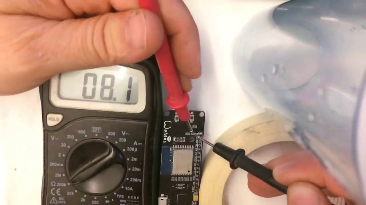

I don't understand what is happening, I tried to do what you recommanded, to place just a resistor between the + and the TOUT pin, it took me a while to find an good value, and I dont know if there are any online calculators, like there is for the voltage divider, but the resistor that dropped the voltage from 4v to 0.9v was a 3.3M resistor. If I measured the voltage between the ground and through this resistor I had exactly 0.92v, this should have been good. But after soldering the resistor on the board, like in the photo bellow, the red wire is going to the A0 pin, the voltage is just 0.2v, I don't understand why this is happening. There is a voltage divider on the board ?
You shouldn't connect anything with output impedance of >about 10k to an analog input. 3.3M is too much: you won't charge up the port properly, which is why you get these erratic readings. As I said before: using a single resistor (or no resistor at all) you will ALWAYS get the full voltage at that port.

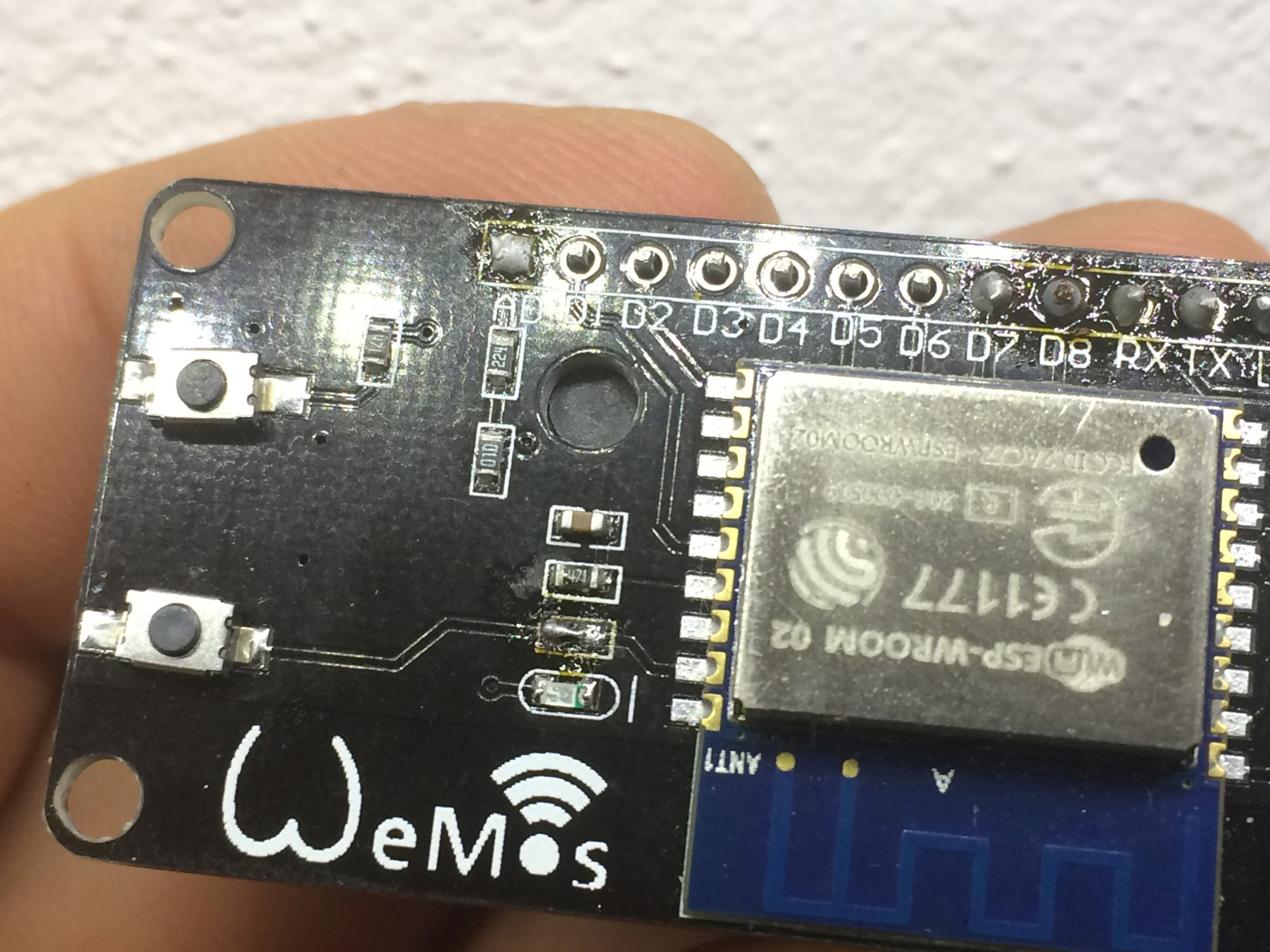

Will try that too tomorrow, right now I made a photo with the 2 resistors that I though ware used as a volt divider ...
Indeed there must be something at that analog port to bring the range to 3.3V but I'm not sure what it is - a plain voltage divider sounds like a terrible idea to me, as the pretty low impedance needed for it not to mess up the analog port, messes up just about any input signal. Haven't seen any clear schematics, and the NodeMCU board is too dense to easily do trace following (and many components are unmarked anyway).
The input impedance of the analog port is supposed to be in the tune of 60M or so. Would require an OpAmp buffer or so.
That appears to be s a 224 (220k) and a 010 (1 Ohm) in series. There is indeed a via connecting to the 010 - wonder where that is leading to. The other end of the 010 is apparently linked to the top plane of the board, most likely GND or Vcc (3.3V).
That doesn't really make sense, as the values are so far apart that you get nearly 0V or Vcc (depending on what that plane is connected to) on that via at all times. So I wonder what I'm missing there.
I got an answer on esp8266.com forum with a link to a blog where there are more details about this board. It seems the R1 is 220k and R2 is 100k, with those values it seems the A0 pin can only measure up to 3.3v .. I don;t get it, what's the point of measuring up to 3.3v when the battery maximum is 4.2v ? This is a battery powered board, isn't it logical to be able to measure the battery voltage with it ?
What you suggestions are regarding on what modifications I can make to be able to measure up to 4.2v ? Is there anything simpler than just replacing the R2 resistors ? I will look over to see what resistors do I have around 68k value, as this is what the voltage divider calculator reported to be the R2 value, to be able to measure up to 4.2v
