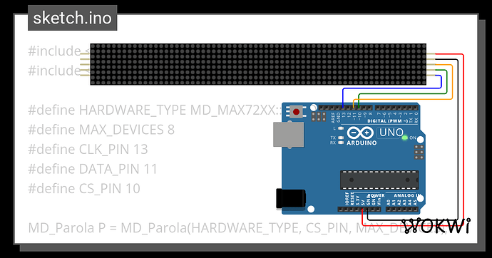

does show any animation at all?
I tried to strip down to just the animation in a WOKWI-Simulation but nothing happends
From calling
no text appears on the dotmatrix
@myousic
From what I can deduce, you are wanting a conditional method to control the animation in and out of the display. I have hacked up a wokwi which I hope you can pick the bones out of and fit to your sketch.
I took the WOKWI-Simulation from user @indev2 and added serial printing to make visible how the code works and what the code is doing
@StefanL38
Yes, code works on my matrix, shows in animation, waits max 65 secs (its max value as you suggested, I tested what value is saved in pause with getPause()) and shows out animation then the cycle repeats.
I watched some youtube video about Wokwi simulation of that display and the code needed some changes to make it work on Wokwi.
