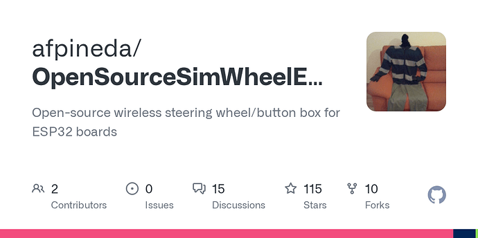

This one?
Did you read this
To use this library you need to have Arduino core for the ESP32 installed (GitHub - espressif/arduino-esp32: Arduino core for the ESP32)
and the installation instructions?
